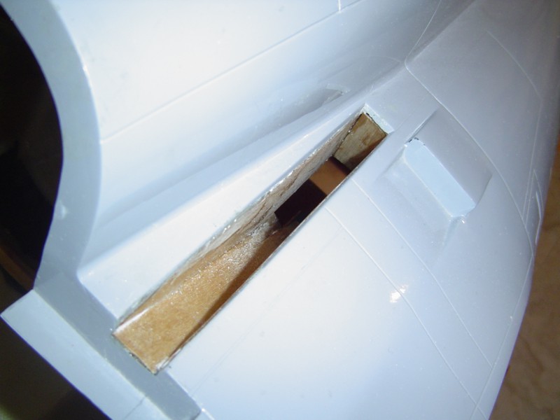

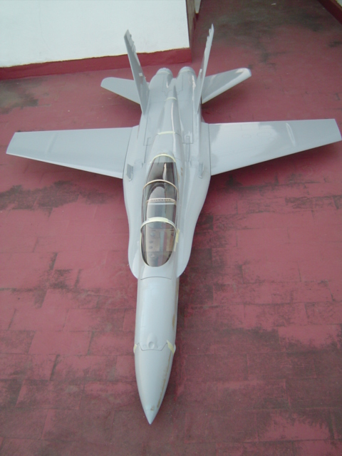

Hi friends:
I am working in a F-18C kit of Jet Legend, but I change to "B" version, for this reason I make some modification.
I hope that you like and tell me anything.
photos...

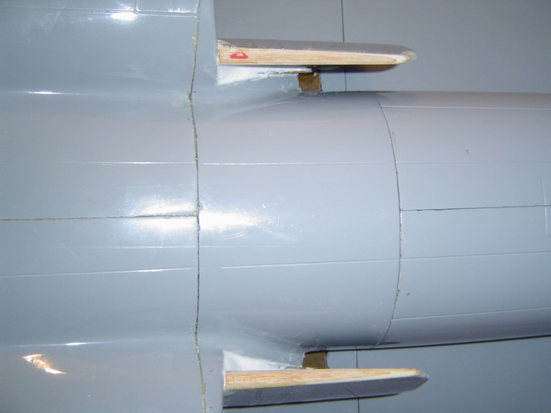

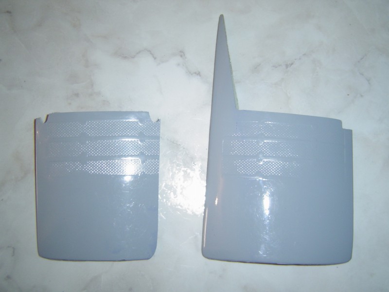

+ photos...
This is a F/A-18B version.
The difference in A/B and C/D version are minims. A lot of panel lines are in bad possition. The nozzle details are mistaken. The infly refueling prove panels are mistaken too. The panel access in the side of fuselage has a small hinges that no are estimated, but in the kit are to much big. and a lot of details that no are to scale....
I´ll like to make the best job possible.

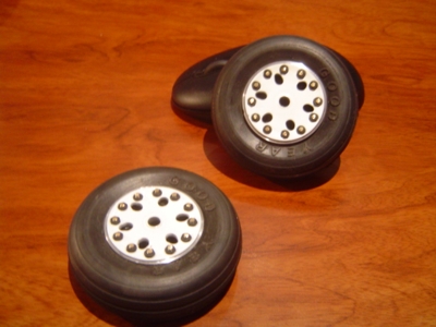

I have the new wheels for my Hornet.
I hope that you like.
Regards.

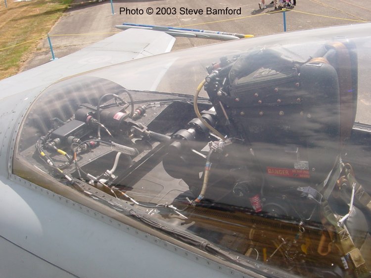

Hi again:
I put the photos of the canopy details.
http://www.rcuniverse.com/forum/m_4939048/tm.htm

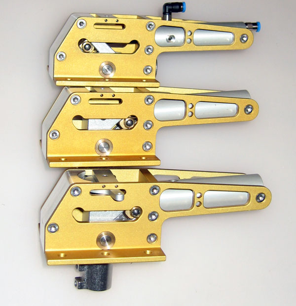

The rig of the horizontal fins are from Jet Legend, I am waiting still for this items, I hope that come to me the next week. I don´t know what happen with the dealer for Europe (Germany) I am waiting for this 4 month.
www.jetlegend.com

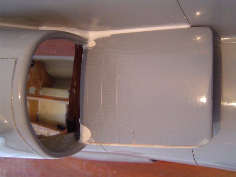

Hi friends:
More details in the canopy.
Tomorrow more.

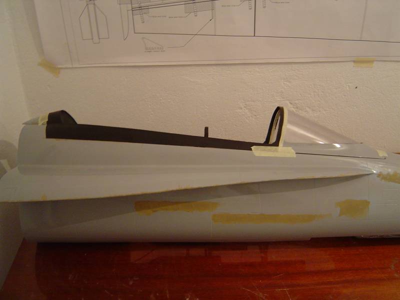

Hi friends:

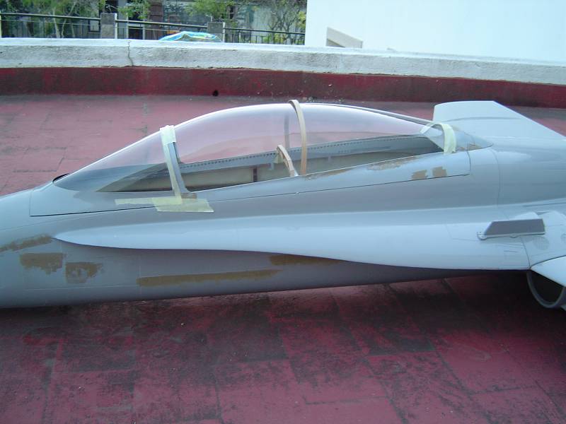

Here are the photos of the detail of my F-18 canopy, twin seats.
Regards.

Hi friends:
My canopy is opetative now.
http://www.youtube.com/watch?v=TVSvX7OBqt4
Regards.

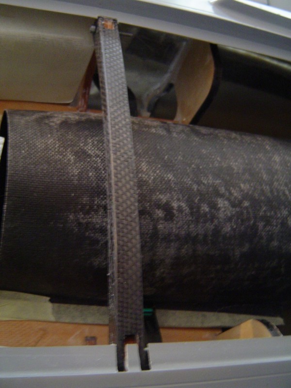

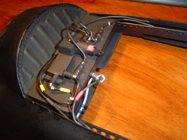

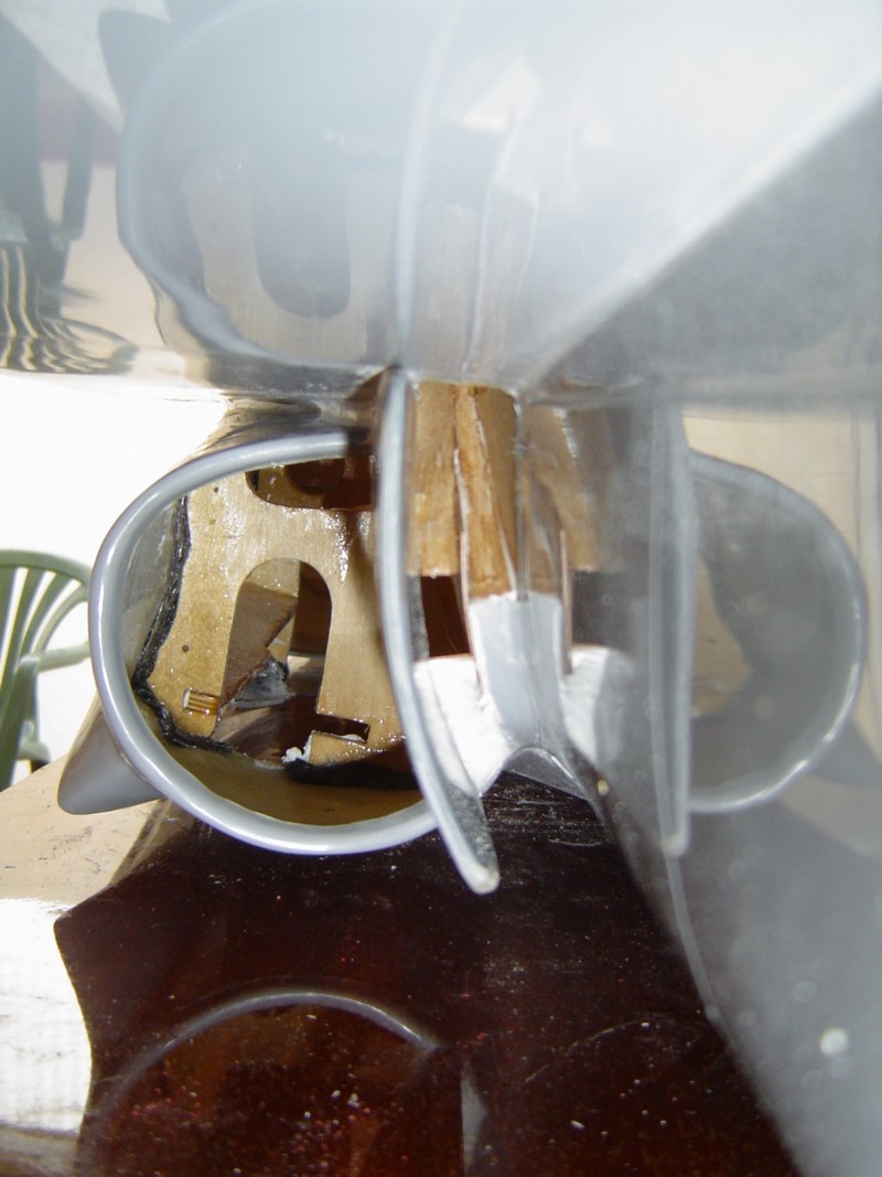

Great! Can you post a picture or video from the back, looking into the nose. Thanks, Great work.
Old 11-06-2006 | 07:57 AM
cmjets's Avatar
Joined: Apr 2005
Posts: 1,773
Received 60 Likes on 39 Posts
From: Pontevedra, SPAIN
Default RE: JL F-18 modification

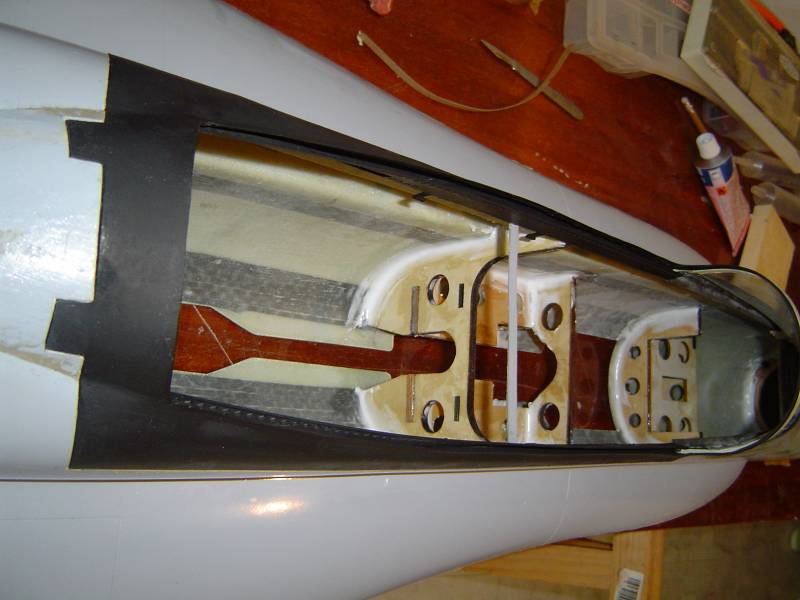

Hi:

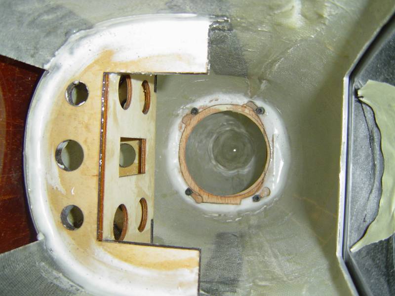

I am not sure that you want to see. I put 2 photos. If you need another, plese, tell me it.
The nose is empty because I extracted the lead in the nose.

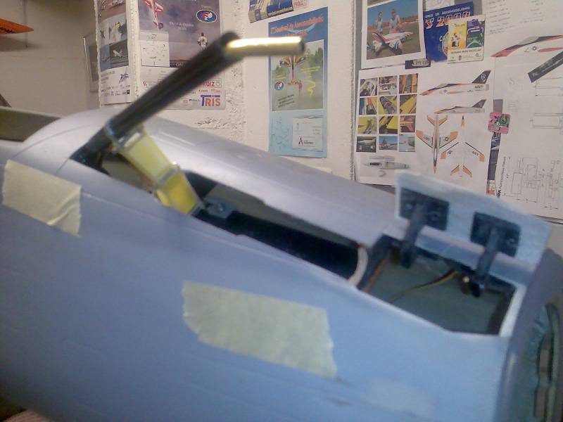

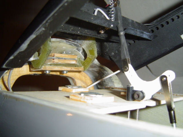

cmjets, can you explain to me how you made the hinges work on the canopy. I was looking at using robart hinges but then when you lift the canopy it will hit the back of the fuse. Please post some pics if you can.

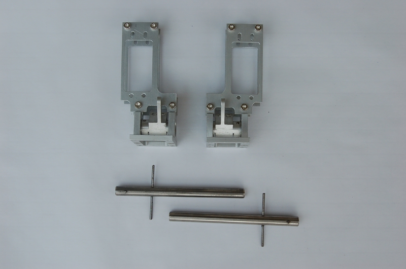

Old 11-17-2006 | 11:23 AM
cmjets's Avatar
Joined: Apr 2005
Posts: 1,773

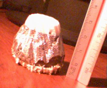

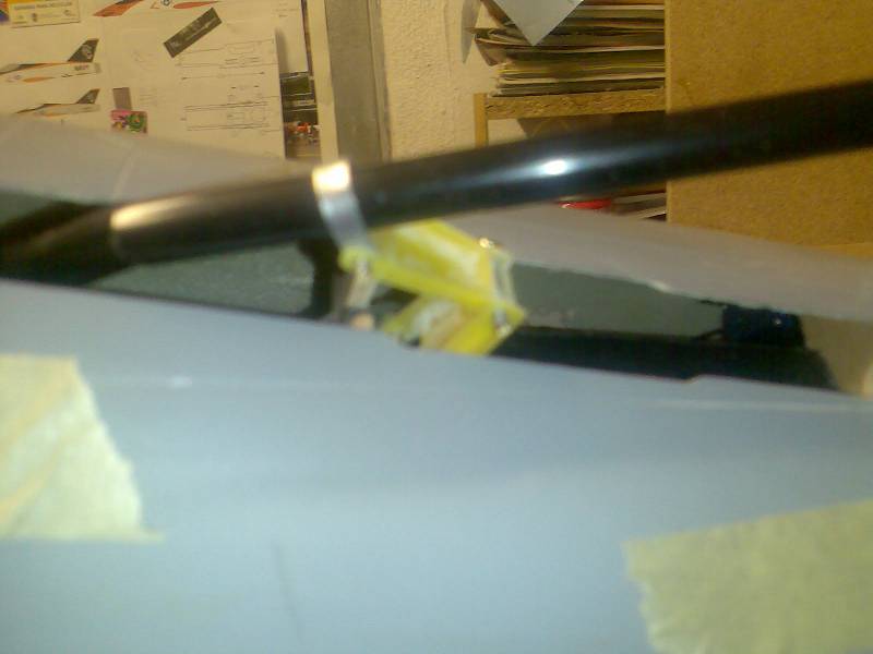

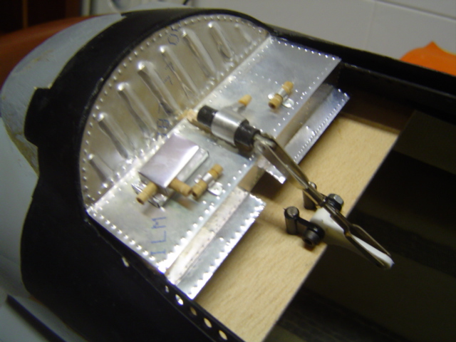

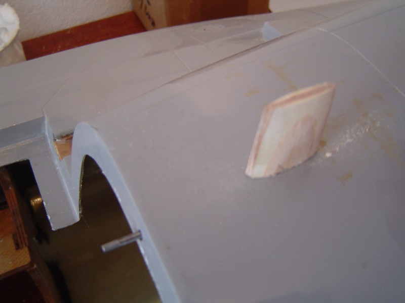

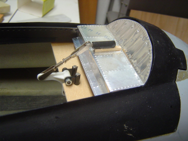

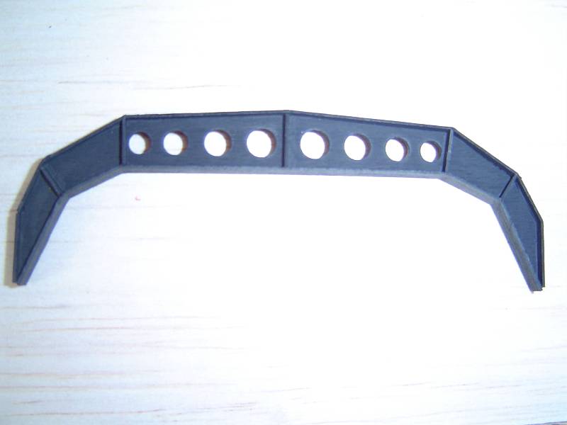

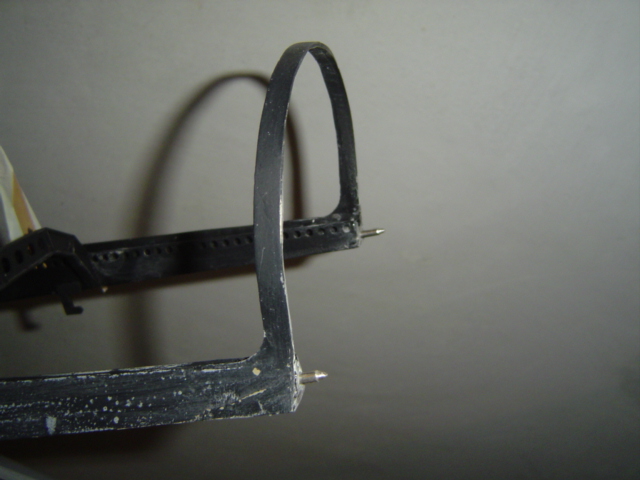

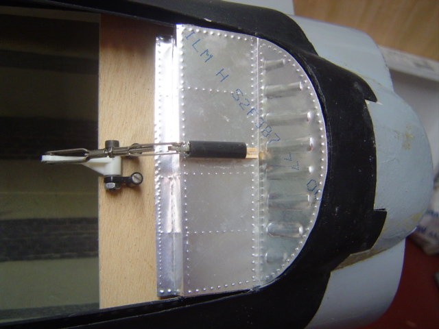

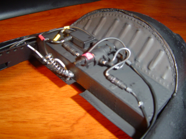

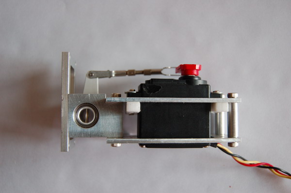

Hi Dig it:
The hinges in the canopy are like the gear doors, but made home.
I made one in plywood for test and them I made it in fiber glass. (electrician circuits).
I put photos of the hinges and the block system. I use a Hitec 645MG for the moviment and HS 81 for the block with a secuencial door system. I swich up and the block is retired, them the canopy is open and when I swich down, the canopy down and them the block is out.
Now I am painting the model, when I install the servos again, I will put a video from inside.
Regads.

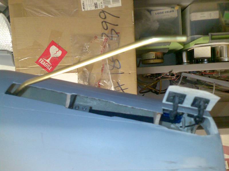

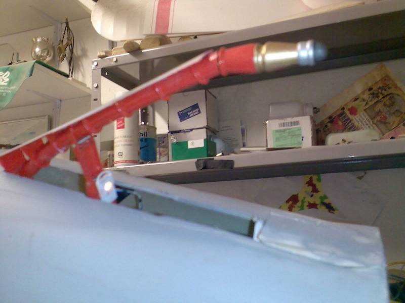

Hello Friends:

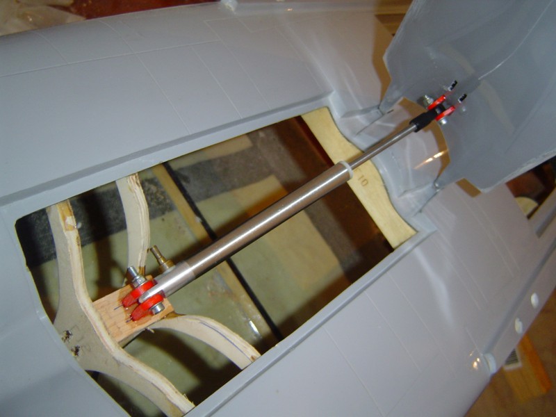

I follow the construction of my F-18. I have a refuel probe.
I put photos and video.
Enjoy
http://www.youtube.com/watch?v=wJU5jAlnkLA
Carlos.

ORIGINAL: cmjets

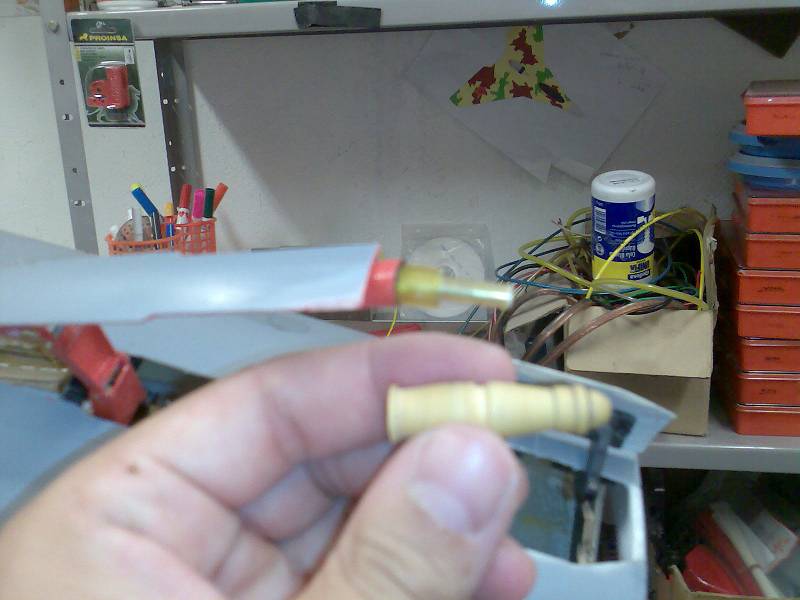

Hello Friends:
Enjoy

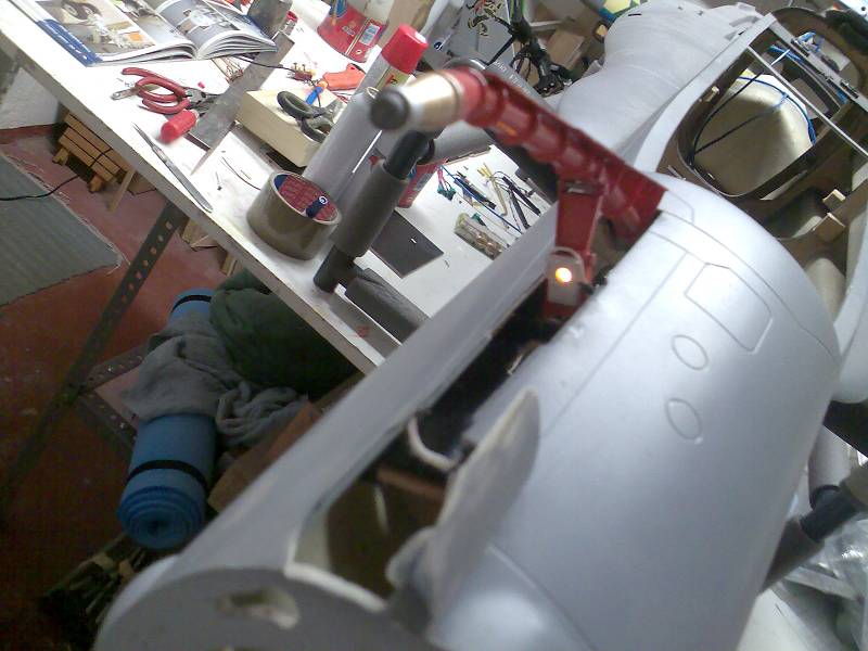

Hi again:
Now is really finished. I put 2 swich for the light.
I put another video.
http://es.youtube.com/watch?v=S0kx-RMp3MY
Regards from Spain.
Carlos.

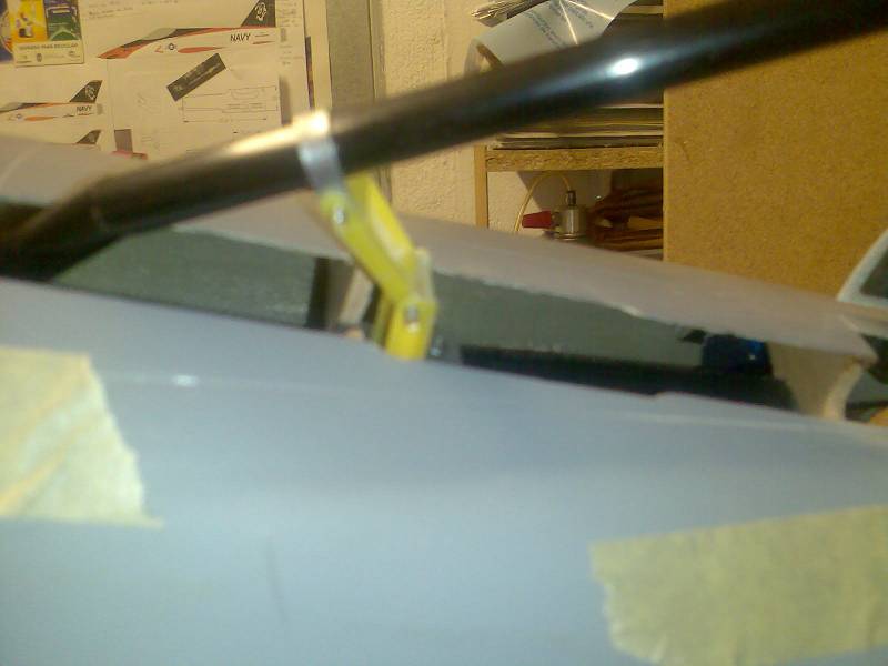

Hi Carlos,
Great refuel probe. Are you going to make it really functional? Now the question is where you can find a tanker for it.
Well done.
Mike
Old 06-17-2008 | 04:18 AM
cmjets's Avatar
Joined: Apr 2005
Posts: 1,773
Hi Mike:
Yes, I need a KC-10 !!!
Inside I have a brass in 4 mm for fill the Kero, but I think that no is suitable for every days, because the system no is strong enough.
Regards.
