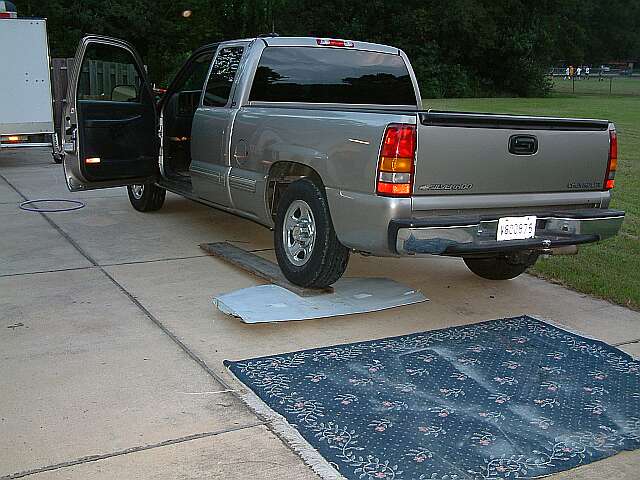

Posts: 1,146
From: Baton Rouge,
LA
Just about all parts are vacume bagged, some
of the larger DC-10 parts, like the center section
were not bagged and it worked fine.
Here is a center section of the a DC-10 what was
melted due to a hot start.
It is three inchs thick, has 1/4 plywood spar with 6 inch
uni carbon over and under the spar and 2 oz glass over the
whole thing.
whole thing.
