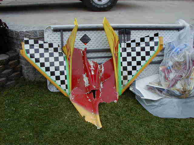

Lost my Hot Spot, bottom section behind main landing gear blow off at about 150+ at 30 ft. hight. Has this happen to anyone else, attach picture shows the piece that blow off, any info will be appreciated. xxspeed

Yes, this has happened previously to Hotspots & Roos. Typically (from what I have read here on R/C U, never happened to me) the lower skin has delaminated and airflow in through the wheel well openings has provided the force to tear the skin off.
What happened after the bottom delaminated? Did it peel all of the way off? Did it hang on and the drag caused the crash? How/why did it go in?
Sorry to see this.

Thanks for the reply, it peel off with no warning and separated from plane, Hot Spot noised down up elevator had on effect, hit about 200 ft from filght line. My though now last year i had a fuel leak on the side that failed maybe that caused the glue to weaken?

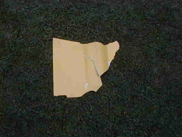

I suspect that your fuel leak could possibly have weakened the plywood on the formers that are glued to the bottom skin. But the glue (I think they used epoxy with a white filler) should not really be affected by fuel. Can you tell if a bit of former is still attached where the bond failed? Or does it look like the epoxy just came off of the bottom sheet?
From the other examples of this that I have read here, it seems like many of the past failures were simply a case of not enough glue used or not an adequate bond from the manufacturer.

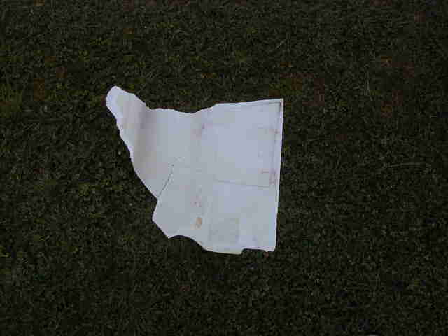

Wokeman, looks like the epoxy came off the bottom sheet, there on pieces of formers at all and the tears are clean that is it just happen. Pic of both sides. Thanks for the reply xxspeed

If the epoxy has just come off of the bottom sheet, that can be facilitated by many things. Like if the guy assembling the fuselage was just eating greasy fried chicken, did not wash his hands, and gets grease on the bottom sheeting where the former is to be glued - disaster. I doubt they prep the bottom surface by roughening it up like you & I would if we were gluing to it.
