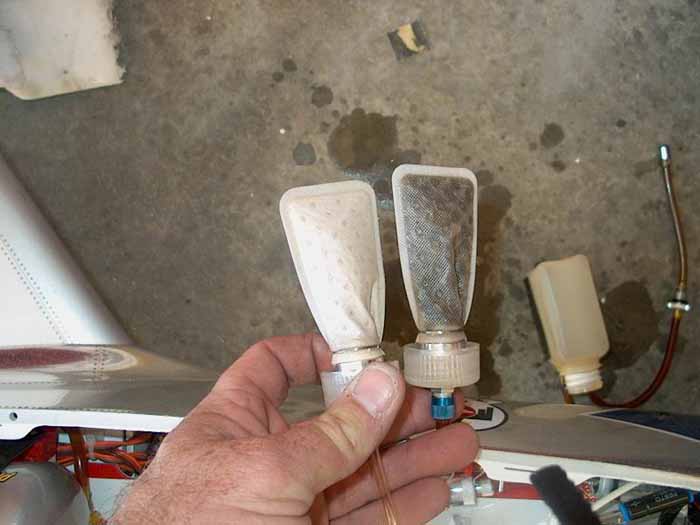

We are currently investigating whether contamination in the UAT may be affecting the low RPM operation of the turbine.
The turbine has control loops that are calibrated to the necessary voltage at idle. If something affects that "draw" too much, too fast, in some cases the turbine cannot recover fast enough and the turbine may quit, sometimes even on taxi out.
Here is what it looks like. We are researching with BVM right now and will keep everyone apprised.

I can just about guarantee that your looking at a good old fashion algae bloom; aka pond scum. Back prior to January, 2000 I had exclusively run Jet-A from the local airport FBO's fuel trucks. During this time frame, I started accumulating large amounts of dark green gooey slimy gunk in the filters that go from my ground based fuel supply to my planes.
Then, during several flights, I started loosing power and I had a couple of flame outs. Once on the ground, I discovered that the filters on board my airplane were clogged up with the same gooey stuff, thereby inhibiting fuel flow and power level. I then came home and closely examined my fuel supplies to discover the same gooey slimy gunk everywhere. ugh...
I did a bunch of research and learned that algae loves to grow in kerosene. Actually, it lives in water that accumulates within fuel tanks and the algae eats the kerosene for food. You most probably got the water/algae from an airport's Jet-A fuel truck or storage tank. Unsealed storage tanks such as the airport fuel truck tanks and underground fuel storage tanks are vented to the atmosphere and kerosene is anhydrous so it absorbs the water out of the air. Contrary to popular opinion, Jet-A (and any other fuel purchased from an unsealed tank) is the dirtiest source of fuel around.
In the beginning, I purchased Jet-A exclusively. However, I have since gone to the odorless K-1 kerosene that you can purchase in the hardware store in hermetically sealed 5 gallon containers which are re-sealable. I have been flying this stuff exclusively since January, 2000 and I have not had another algae episode yet. All of my UATs remain totally white (except for a little pink from the red dye in the kerosene). I check my filters often and they are always totally clean. While the hermetically sealed K-1 from the hardware store is more expensive than Jet-A it is more than worth the price. Its absolutely the cleanest stuff around. I have purchased both the Crown and the Parks brands of hermetically sealed Kerosene and have found them both to be equally free of any type of contamination.
So, anybody that is noticing your UATs turning dark green need to consider changing your fuel source. I would also recommend that you either replace the contaminated UAT or the UAT's bag. Otherwise, you definitely will eventually run the risk of a flame out due to the algae clogging up the UAT or your fuel filter.

This is what John Redman wrote me
Well guys I had a couple of low rpm shut downs on my Bobcat the other day. What I noticed was the rpm falling to around 27,300 from a full throttle to idle transition and then on occassion when I taxied out for takeoff and hit the brakes the engine would shut down with a low rpm condition.
I talke dwith Gordon Dickens as he had encountered the same problem. I gave him the info and he directed me to the UAT. I had mentioned the UAT because of how dark it was. I had suspected it as well, but didn't want to go the $50 way.
Well I pulled the bag out and it was down right discuting. This UAT was in my last Bobcat and now the new one. The UAT has seen close to 300 flights. Now as we know the UAT sits full all of the time. There will be times where I don't fly for a couple of weeks. My guess is the algae groth occured during those times.
End prognosis is if you don't plan on flying for a while then it might behove us to drain the UAT. This is just a thought. I have ran exclusively JP-8 with mil spec 7808 engine oil. This could be a determining factor as well. Now that I am out of the Air Force game I will be running Jet-A. I will continue to monitor this for a while. Don't have a clue about kero as I haven't used it. I do believe if you fly at least once a week, then you have no worries. Fuel continues to transfer through hte system without a chance for growth on an expanded schedule.
I plan on calling BVM and seeing how much these bags are. My guess is they will be cheaper than a UAT tank and they are a snap to change.
Pics are attached to show the discoloration.
John
John

Matt- I agree with Gordon that you are looking at good old algae bloom.
You might consider using the Jet Model Products accumulator in place of the UAT.
The advantage other than impact resistance of the aluminum construction is that no sunlight or UAV rays can penetrate the canister.
RESULT- NO ALGAE BLOOM
Those of us that have been using their system for over two years have had none of the problems that you are experiencing.
Clean fuel to the engine every time.

The JMP filter is a nice item but won't prevent bloom due to it's metal opaque housing. The kerosene algae grows fine in underground tanks at airports, in jet fuel tanks, and in my dark blue opaque fuel containers.
All you need is a good dose of contaminated fuel, lots of air interface, like with 1/2 filled fuel cans, and heat.
I have never witnessed algae blooming in the UAT itself. It formed in my blue opaque fuel containers, and then was trapped by the UAT.

Well guys I am a little late but here I am. The pics of the UAT are from my Bobcat. I sent the pics out to a few people who I know run jet cats. I went to Matt as well as Bob Wilcox because I know they won't let this thing die until we are exactly sure what to check for and prevent in the long run. I have come to the conclusion that it is algae inside the UAT bag. I run JP-8 exclusively, as well as Mil spec 7808 oil (I believe this is the same as aeroshell 500, but not sure).
The UAT in my Mig looks very similar. Since installing the new bag I have noticed that the RPM's don't seem to fall off as much as before. I have been running the engine on both Jet-A, JP-8, and Kero K-1 from Crown. I haven't flown much at all in the last month due to preparing to make a family move and such.
Don't sweat anything yet. It is apperantly obvious that there was a large amount of algae growing inside the UAT bag. But here is the good news. This bag is also an unbelievable filter in that the max pump voltage never went up at all for the simple reason that none of the algae left the UAT. The UAT bag is large enough to handle this without a problem in the air.
Being as large as it is did not affect the medium to high output of the engine, as well as the filter in the fuel line from the pump to the fuel valve is clean. There is absolutely no evidecne of algae anywhere inside the fuel system except the UAT. So the end result is the UAT did more than its job in this case.

I am not sure if this helps. This a pic of my UAT from a 50 flights Hot spot. I used JetA, Gas station Kero, Ace hardware kero and a friend's kero. It looks perfectly clean to me. Just FYI!!!
Now I hope I will not get a flame out due to air bubbles in the UAT after inspection for this shot

Well guys the UAT bag went to my Boy's High School to be looked at under a microscope to see exactly what it was. Mike Danchak made this suggestion just to make sure we knew what we were dealing with.
Well it turns out that most of it was dirt. The Biology teacher who looked at the contents of the "gunk" under a microscope said while there was some algae, most of it was dirt. His descrition came to be that he felt the algae content was no more than 20% on hte stuff in the gunk.
I found this definitely interesting. the end result is it wasn't a large algae bloom as some of us suspected. What does this mean, well nothing really, it is just more information for the puzzle. I will continue to work this issue until I am sure what is going on.
I will keep you informed.
John Redman

so, and I am just speculating here, is it possible for dirt/dust to enter through the main tank vent on the jet..? Should modelers be thinking of some sort of filter for the vent line? This could raise a whole new set of concerns about getting clean air in the tank without causing a vacuum, and fuel starvation... Again, I am only speculating....I am just about to lay the plumbing for my first jet, so this comes at a very appropriate time.....
Thanks....
Wayne B.

Hi David,
I believe that full scale turbine engines are capable of handling dirty fuel a bit better than our miniature turbine engines. I am not an expert here, however, I believe that is the case. In any event, the Jet-A that I have purchased over the years has not been very clean. For example, the Jet-A that came out of the fuel truck at the Lakeland, FL airport this year at Top Gun was very suspect. Joe Rafalowski has a water trap that he pours his fuel through into his 5 gallon storage tank. He put about 3 gallons of Jet-A in his storage tank at Top Gun from the Lakeland fuel truck and ended up with several ounces of water in the trap. The mere existance of water in the fuel virtually guarantees that algae was also present.
I don't think that our miniature turbines would care about this much either if it were not for the very fine mesh filters that some of us use as well as the UAT which also has a very fine mesh. Algae will go right through a coarse mesh filter such as a Sullivan Crap Trap. I have even seen it get by the fine mesh filters such as those used and recommended for JetCats. That is why I double filter my fuel going from my ground supply to my airplane tanks. So, if you don't use a UAT or fine mesh filters then the algae probably doesn't matter very much and may not clog your fuel filters.
While I am not a full scale pilot, I am a fractional owner of a Learjet 60 and I have often overheard pilots talking about not wanting to take fuel from a truck that is getting low on fuel because of the algae, dirt and water that they believe accumulates there.
FYI,
Gordon Dickens
http://www.gajets.net
