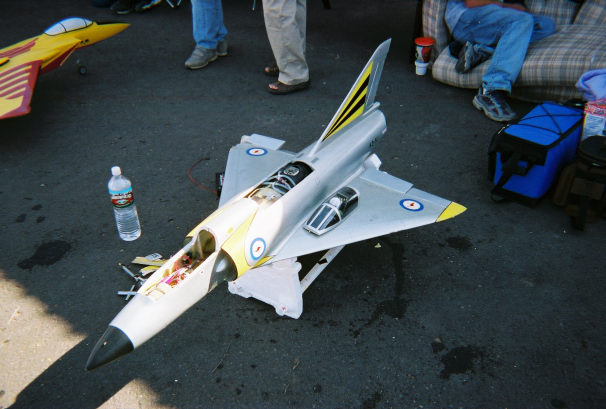

Here are some pictures of my JHH Mirage and one from the Arizona Jet Rally, they my help.
If you would like to see more pic. of my mirage internal and external let me know.
Carlos

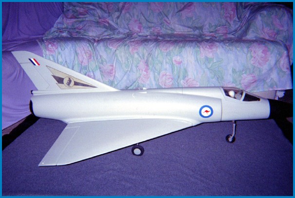

I'm very sorry, that's not what I wanted to send, wrong disk.
Now here are the real pictures.
Carlos
CARS II

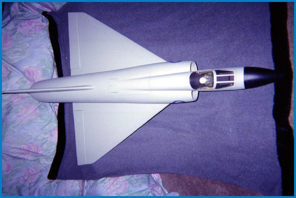

Top

On the previous pic. the Mirage was flying up side down.
top.

Default JHH Mirage

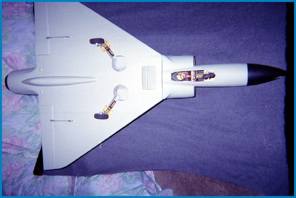

Here you can see the ailerons and the elevators clearly. I also have the builder e-mail if you like to ask him any questions about it.

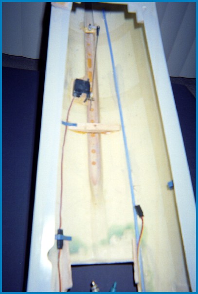

Carlos,

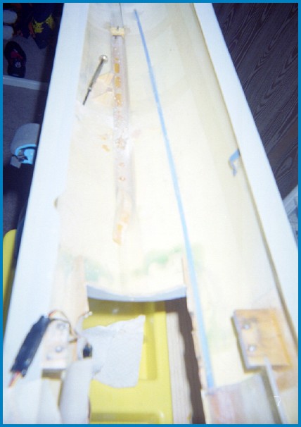

If you could post some internal shots that would be great. Have decided that I would make some internal formers for the fan ubnit as I don't like the idea of just mounting a couple of plates to the side of the fuse to mount the fan on it.

Default JHH Mirage
Here is what I got.
If you are going to use a bigger engine the the formers are a good idea, I'm using a K&B .45 so the plates are more than sufficient, the airplane has flown more than 25 times and there is no signs of damages on the plates.
Pictures.
Carlos

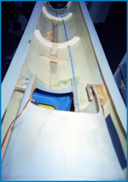

I added two half formers under the fin, the original builder had one very small piece of soft balsa under the fin as a former, when the airplane flip over during a landing it just came undo.

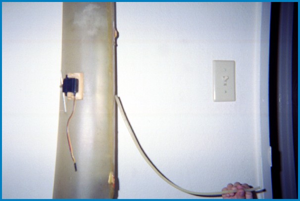

Default JHH Mirage
No formers here.

Default JHH Mirage

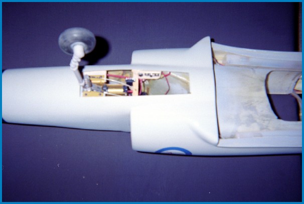

Here you can see the rudder servo with push rod, old former for the fin.

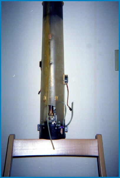

Old 01-14-2003 | 05:23 PM
CARS II's Avatar
My Feedback: (7)
Posts: 6,658
Received 137 Likes on 120 Posts
From: Sacramento CA

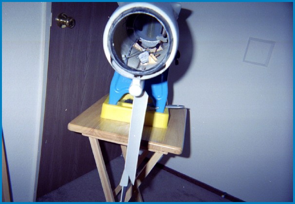

Default JHH Mirage

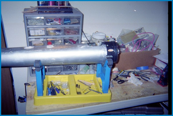

Thrust tube the way it was with the servo attach to it, no more, now I have move the throttle servo and the in flight needle servo mount on the fuse just behind the fan unit.

Old 01-14-2003 | 06:38 PM
Thud_Driver's Avatar
Posts: 1,669
Received 9 Likes on 7 Posts
From: Victorville, CA,
Default Engine Mount Plates
I just used the plates stuck to the fuse sides with my setup. Worked fine for the .91 size DF units I used and never came unstuck. I also did the saddle tanks like E-120 driver is showing. I had all my servo's (except elevons) up front for Cg purposes. Make sure the fin mounts are strong. Mine had a habit of doing rolls on the ground if I turned too sharply.
For the last 50 or so flights with the Ramtec/.91 setup, I covered over the cheater hole. It wasn't needed. Takeoff roll didn't change and it was faster up and away.
