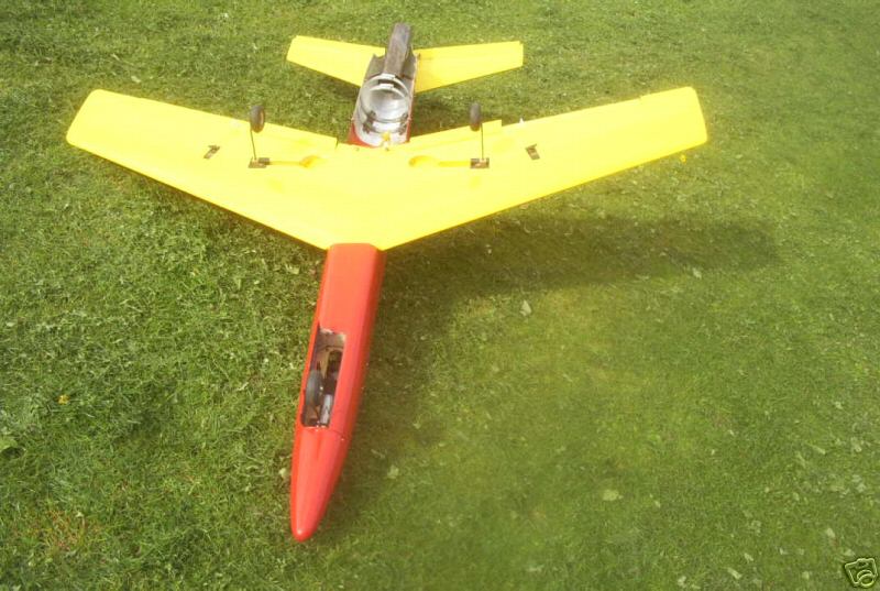

Help! I have just aquired a Westbury Products Sagitarrio. I know its getting on a bit, but do any of you have any info on it? I would like some idea of the CG point and any other tips please. I have fitted a JetCat P70 but have not flown it yet.

Hi
Westbury Products bought the sagitario from Z-Models.
http://www.zmodel.it/
I still have one of these, if you struggle getting the info from the manufacturer I will try to dig out the instructions etc
PS it use to go very well on a mw54 m1

Hi
Ive just measured to the CoG line placed on the wing a few years ago, from the dowel plate measuring back = 220mm, from the wing fixing plate measuring forward = 130mm.
Hope this helps
