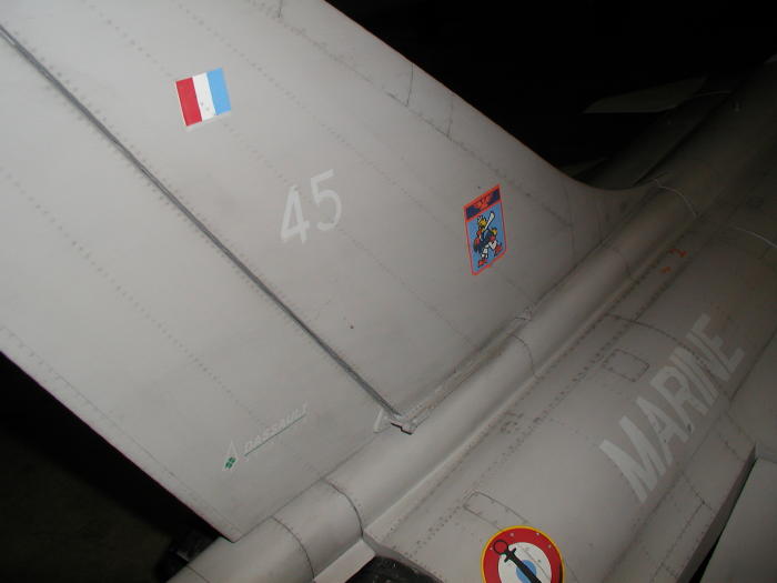

Posts: 70
From: Houston,Tx
Default Panel Lines
Todd, I just finished the detailing of my AD Rafale and here are a couple of pics. I used a pencil to accent the panel line after all the graphics were applied and the airplane clear coated flat. I then burned the rivets in the paint. After that I took some artists powered charcoal on a piece of fine Scotch Brite and rubbed it on the paint in the direction of flight. This left the charcoal in the rivet indentation and accented it very nicely. It will also leave dark streaks in the paint that look like smoking rivets and leaking oil and hydraulic fluid. The charcoal will stay on the paint and will not come off if you wipe it with water or cleaner. It will come off with enamel reducer or laquer thinner however if you overdo it. If you want some more info on the method I used, give me a call at 713-408-8221 Mike

Old 01-17-2003 | 12:23 PM
Posts: 401
From: sao paulosao paulo, BRAZIL
Default Panel Lines, how to?
Hi,
i´m the Rafale guy that Todd have told....i done that finish because the painting of the Rafale wasn´t scale. if you wish an impressive scale finish, you can select some panels, mask around and apply a color a little darker and a little clear to highlight some panels, like paint have weathered or panels replaced. i have painted an all silver fiberclassics F-86 and the result is impressive, just check around rcu and you will see how it looks.oh yes, and after all, give a good matt clear, this will give the final scale effect!
regards, fred
Mike,
What did you use to burn the rivits in...soldering iron? For the panel lines, are you just using a standard #2 pencil? Rafale looks awesome! Thanx...
Todd
Old 01-17-2003 | 07:00 PM
Posts: 70
From: Houston,Tx
Todd, I used a wood burning tool I got at the hobby shop. I drilled holes in the tips that come with the tool to accept 1/16 and 3/32 brass tubing. Sharpen the end of the tubing and it makes an indentation like a rivet. You have to have some way to regulate the temp of the wood borning tool , so I used a light dimmer wired into an extension cord. For the panel lines, I just used a standard #2 pencil. Mike
