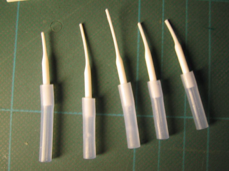

A couple of tips following recent use of Hysol. Some nozzles are better than others at mixing the glue and the ones from Dreamworks seem to work best as they have what looks like a metal insert with finer "pitch" than the others and are longer than the standard "short " nozzles. I have had occasions when the Hysol has not hardened and its a pain as the glue has to be totally removed from the joint, cleaned up and start again. A couple of days ago I did my usual, prior to nozzle application, I forced glue out of the tubes and quite a lot of hardener, the brown stuff, came out before the white. When both were egressing equally I put on the nozzle squeezed out a couple of inches and started glueing, some of it STILL did not cure. Early this morning I repeated this and squeezed out six three inch long beads of glue, only the third and subsequent beads have really hardened, the first two have stayed soft and gummy. So if you are using Hysol don't be afraid to squeeze out at least eight inches of glue before tackling the joint, wasteful yes but it seems the only way to guarantee a good joint. Of course for small jobs hand mixing of equal amounts of brown and white works, but MUST be mixed very thoroughly.

You can always discard the nozzles (when used!), squeeze direct from the dispenser into a mixing cup (McDonalds sauce cups or Ikea sauce cups which are plastic and free) and mix it up with a wooden coffee stirer - free from all those coffee shops!
Order some bulk 2.5ml or 5ml syringes (cheap as chips) and transfere your mixed Aeropxy to syringe. Then the only cost item is the syringe which is easier to get into tight spaces and far cheaper than nozzles and acetone - a lot less fuss and a lot less wasteful on the Aeropoxy left in the nozzle.
To get a really thin applicator try adding some cheap silicone tubing to the syringe, heat up a cotton bud (ear cleaning thing) in the middle of the plastic and pull appart with light pressure. The end result is a thinned plastic tube which if cut in the middle and at both ends gives two very fine dispensers when pushed into the oter end of the silicon tube - great for cyan applicators too
