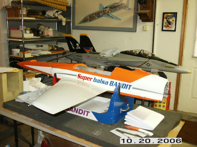

My SBB is on it's second life....I'm installing composite wings on it right now. I smacked the gear through the upper skins of the SBB wings, and I had some strange trim corrections built in as well.
Here it was before the composite wing change:

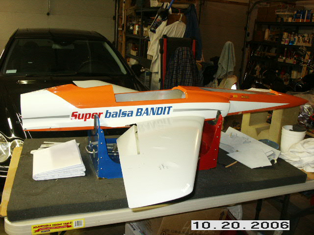

And,
Here it is during the wing change.
I totally gutted it and removed the wing attach frames, and replaced them to ensure a perfect fit.
