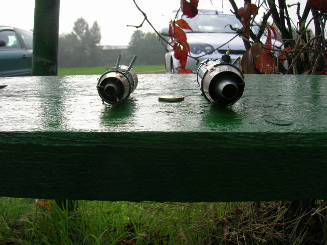

Here the turbines small of the world.

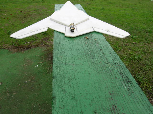

Old 10-23-2006 | 03:45 PM
Banned
My Feedback: (119)
Posts: 7,676
From: nyc, NY
Default RE: MIcro TURBINE
More!

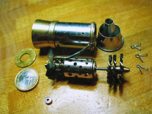

Old 10-23-2006 | 04:25 PM
339tricolore's Avatar
Joined: Oct 2006
Posts: 110
From: san donato milanese, FL, ITALY
here the during test , end final fly the trust 10N

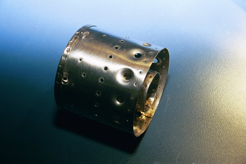

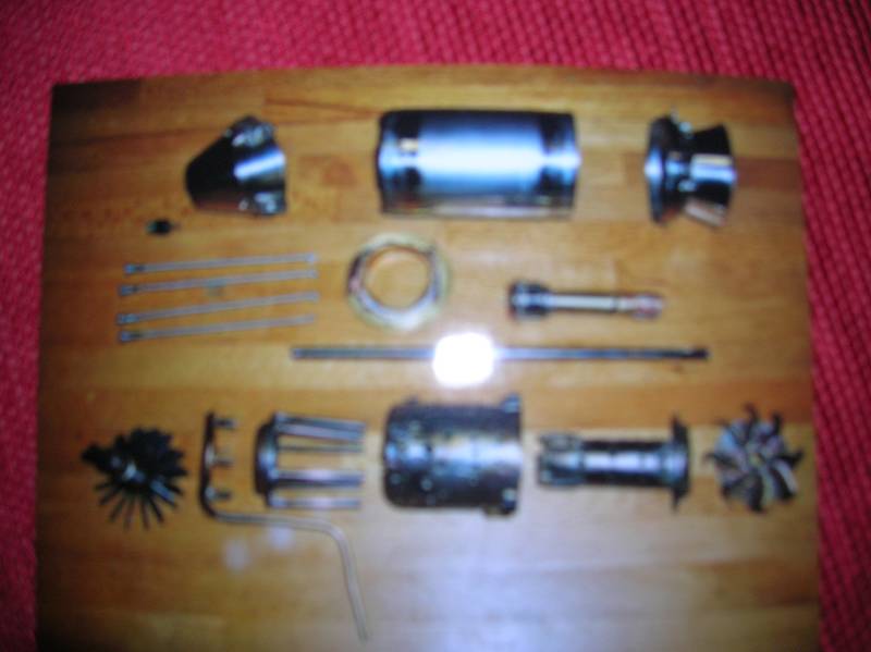

Trying to upload photos of my contribution..........Ahh there we go. What a pain, built back in 2001. 2.5 inch dia engine, 1.5 inch turbine and compressor, not the smallest in the world, but small enough to drive you nuts trying to get it to run.
Vaporizer ring shows diameter of combustion chamber.
Andy

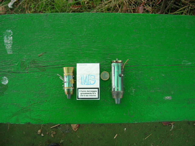

Old 10-23-2006 | 07:27 PM
Joined: Oct 2006
Posts: 110

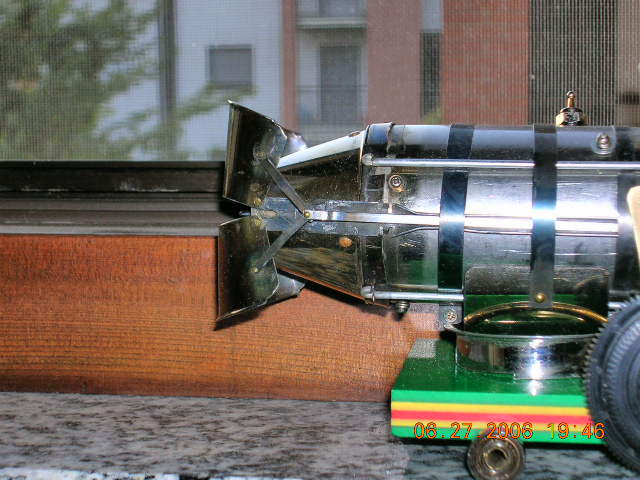

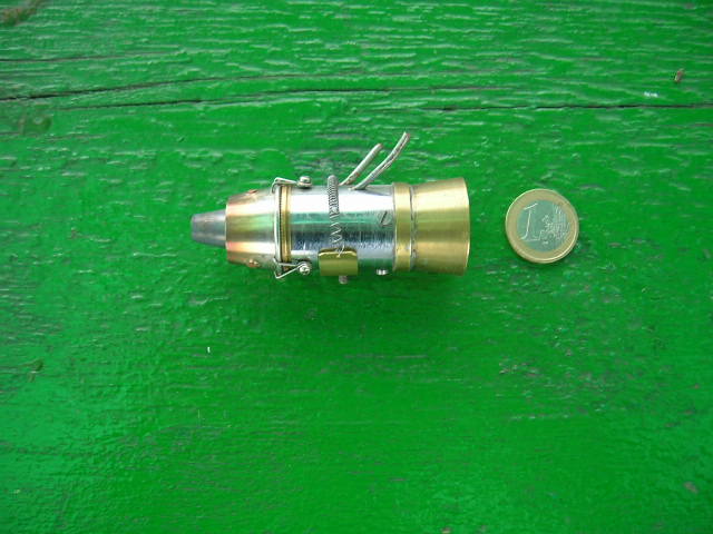

HAHAHA,I have the engine 2.3cm. is very small to see in photos end you not have the revers trust
st hahah NIKI.

Old 10-23-2006 | 07:55 PM
Joined: Oct 2006
Posts: 110
this turbine is made by hand handicraft, the compressor, the turbine works to hand.è , the tests has been hard...

also I have made motor small to vapor, to can see photo 10 micro motor
regards Niki

339 tricolore, amazing work, absolutely amazing. I can only imagine the hours and days of intense work it took to build these engines, although in the end a tremendous accomplishment.
Reverse thrust too! That is some of the best model engineering work I have ever seen. Looks like a real JT8 thrust reverser bucket.
So, does the longer engine have an axial compressor?
I would love to see closer pictures of your engines, especially the compressor and turbine, they look to be of unique design.
Keep up the good work, and keep the pictures coming...........I will post more soon.

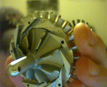

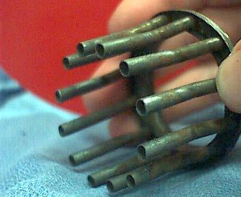

More of my little turbine. I think Tricolore wins, although I think Ewald(Pegasus) is working on something that is pretty small last I heard. Compressor shown in the 4th photo was a CNC programming boo boo, so it never ran, just used it for fitting purposes.

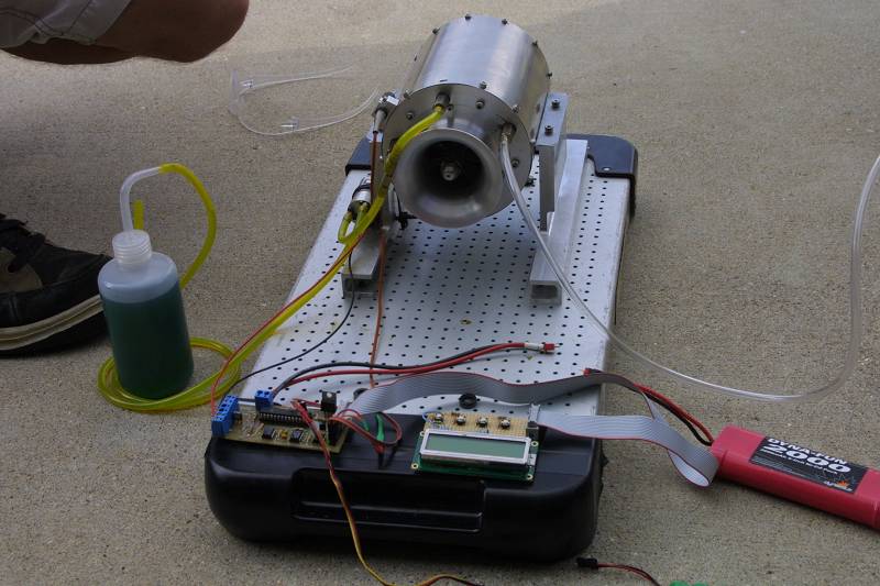

Not quite a micro micro turbine, but here is my latest homebuilt., since we are on the subject..... 73mm compressor. Roughly based on KJ, Wren style construction. Photo on test stand shows first test run, with prototype ECU, so far so good, although did have some turbine to shroud rubbing on cooldown. I have no idea what the thrust will be on this one, should be quite low, with hopefully low fuel consumption with a rather small throughput, hi pressure ratio compressor. Engine 4.75 inches in diameter, came out a little heavy. Built on all manual mill and lathe, no CNC whatsoever. Runs on $4.00 bearings, although I have a great source for gr 5 ceramic balls(they are modified for full 11 ball compliment). Hand ground Inco 718 turbine wheel(dont' ever want to do that again), believe it or not, even the diffuser was cut on a manual mill, with a lot of thinking and fixturing, did I mention thinking????
Andy
Oh yeah, runs on Diesel too!

McJustis, nice work, I have seen some of your photos before. The larger diffuser is quite interesting, how are the axial flow straighteners machined?

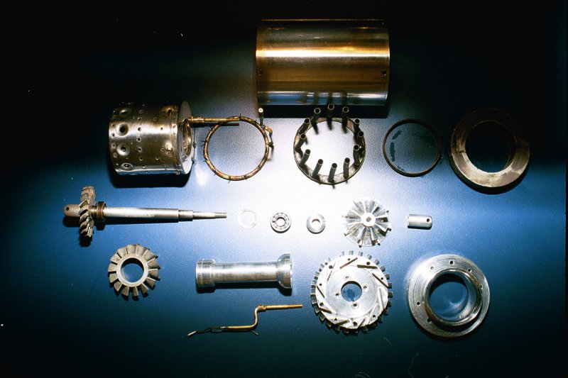

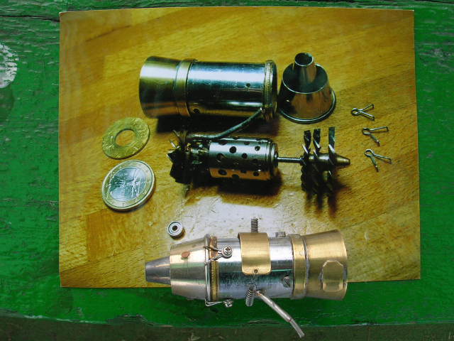

hi peoples here to see the compressor 2.00 cm end the turbine small.....I am completing the proggetto, F117 I am the eurofhather in micro I upset some, lambert coast 2400$ the my coast 100$ manufacture..........
