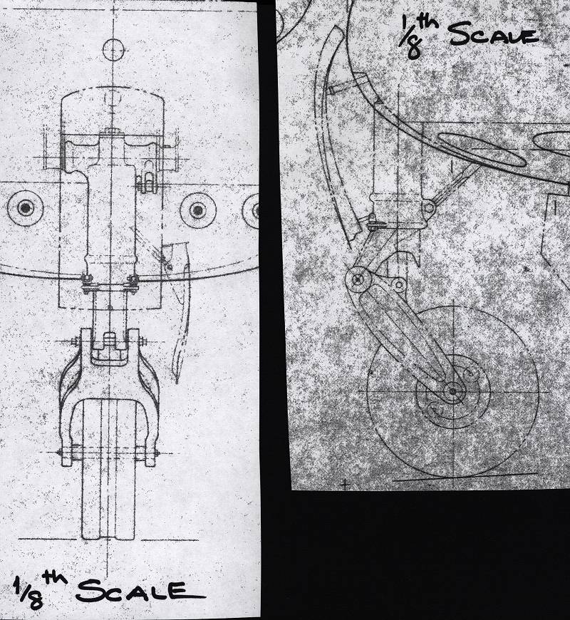

Has anyone figured out how to get the nose gear door on Kerry's Vampire to work?
Seems to me I've spent as much time trying to figure it out as it did to build the plane (not really, but it's brought construction to halt).
Any ideas or pics would be greatly appreciated.
Jon

The problem with that thread is, it shows how the real door works. Because the geometry of the retracts is different than the real thing, pivot point/location, you can't do it the way DH did it. All I know is I must be missing something because no matter what I try, I can't get it to work. On the other thread I figured out the pivot point for the NG door to work properly, but you can't get it to fit inside the model; it's forward of the #1 former, almost touching the f/g nose cap, there's just not enough room. Tried Robart offset hinges, that didn't work, in fact, everything I tried hasn't worked!. It's pretty frustrating, I finally can get back to finish the construction, only to be held up by a stupid door!
I'm not sure I understand your question, but the door fits in the fuse as the fuse opening is a mirror of the door, 45 degree notch and all.
Have no idea why they would've made the door that way.

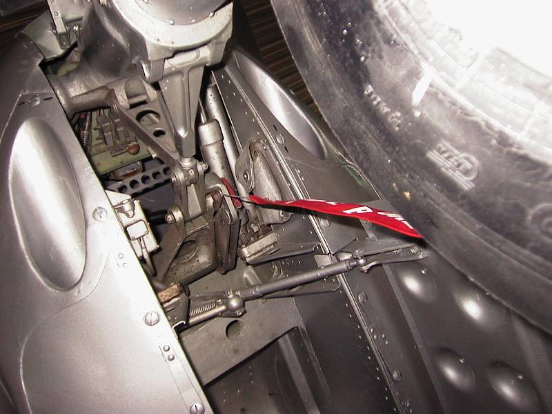

Per Strommen's Avatar
Joined: Apr 2003
Posts: 141
Received 5 Likes on 5 Posts
From: Son, NORWAY
Default RE: Vampire NG door

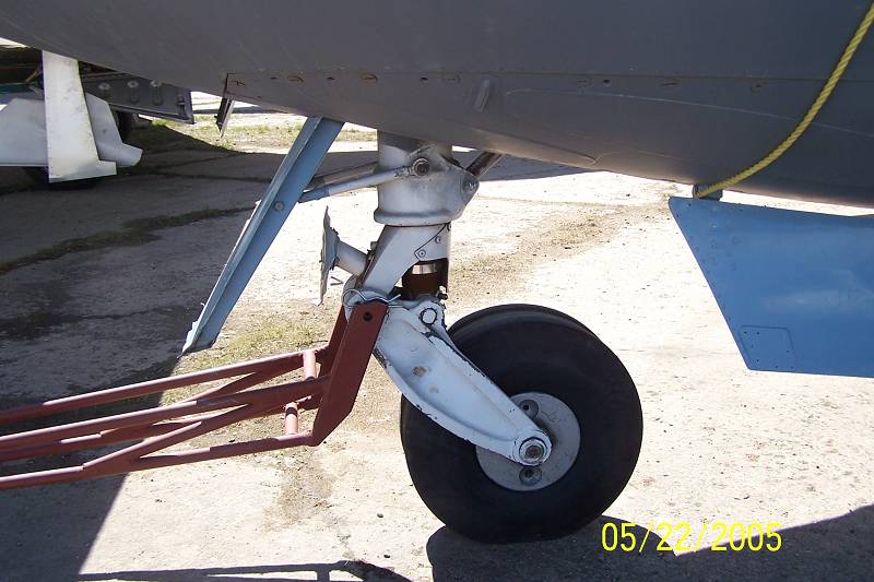

The top/forward hinge is more like an "H" acting as a standoff and with the legs just long enough to enable the door to close flush.
The bottom/aft of the door is hinged to the gear leg.
Even with a different geometry of the retract, this should be possible to copy with the necessary adjustment of the length of the "H".

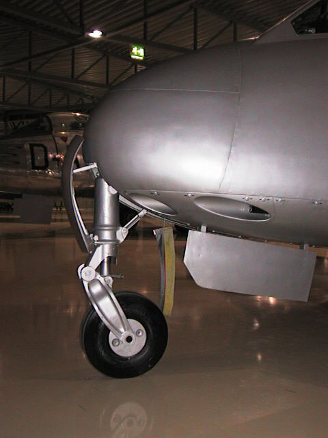

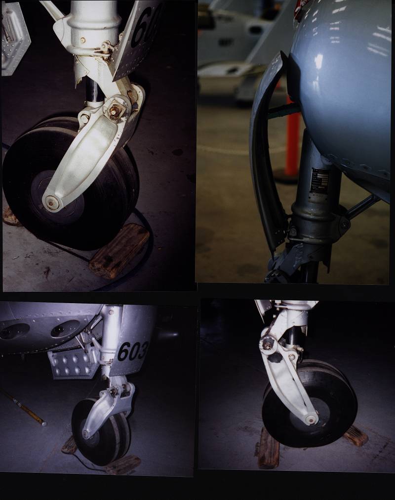

Joined: Apr 2003
Posts: 141
From: Son, NORWAY
Hope somebody can answer Nony on the notch. Seems like they flew with the triangle open. Maybe it was needed to make the door clear the leg during retraction/extension. The door is pushed open and closed by the leg and held in position by an over-center spring mechanism. Could be an air intake, but the cabin ram air intake is the little hole in the center of the nose.

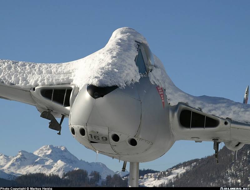

Wayne22's Avatar
Posts: 5,394
From: Strathcona county, AB, CANADA
Old 11-02-2006 | 08:44 PM
Wayne22's Avatar
Posts: 5,394
Thanks for the pics Per....
The 2 place versions have a triangle shaped piece at the end of a stand-off attached to the nosegear strut...this would cover the notch when the gear is retracted....

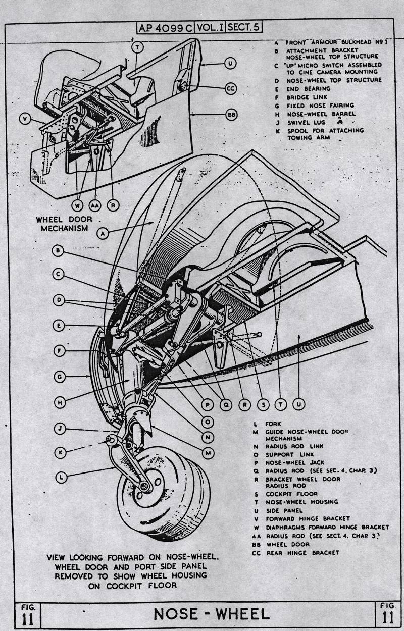

Hi Jon:
The nose gear - forward door works with 2 mechanisms. The first is a trapeze attached at the TOP of the door and just inside the nose gear opening in the fuse. This allows for the door to swing OUT away from the fuselage and UP when it opens.
The 2nd attach point is from the door to the lower strut directly. You will not be able to connect at this specific location on your gear but just above it.
Please see photo and I have attached the DeHavilland VAMPIRE manual drawing to illustrate.
If you still have questions please give me a call.
