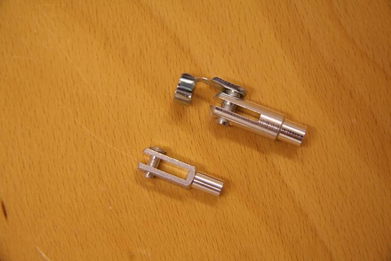

...I can get some heavy duty linkages such as the ones in the pic below that will allow a thicker servo arm to fit??
The two I have below are very nice but only allow the smaller, thinner 2mm thick arm to fit. I need to fit the 3mm or 4mm metal arm.
The link needs to have a 3mm threaded insert too as the ones in the pic do. I cannot use ball links etc as the centreline of the metal arm is exactly central to the control surface horns so the linkage setup is spot on - but only if I can find a suitable metal link []
Any ideas anyone???

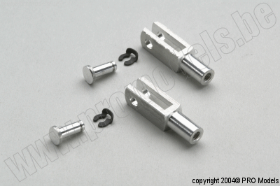

The ones I have in my drawer are from Protech.
They have a 3.05mm gap and M3 threads. I think the p/n is MA665
Lars

those look like SWB servo arms to me (the red ones ) .. they are very nice .. they clamp around the splines of the servos. I think www.chiefaircraft.com carries them ..
