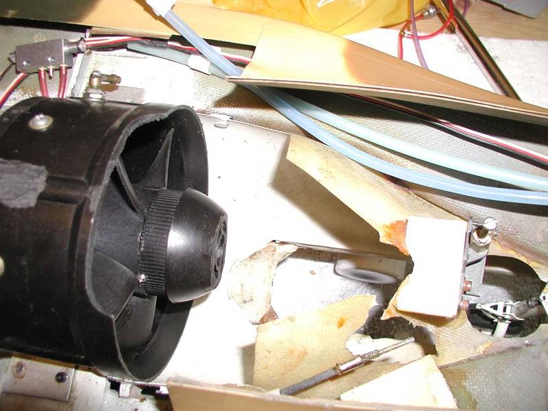

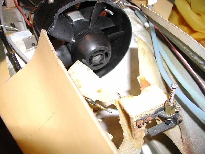

I bought a JHH F-16 off a guy. It has a K&B 40 and I'm not sure what kind of fan. The problem is that I don't see how I'm supposed to start it. The nose of the fan unit has been shaven off and a regular starter cone doesn't fit on it, not that you would get it in there anyway. Does anybody have any ideas on how to fix this or even tell me how this should have been from the factory.

Looks like some of the fan blades have damage!
Be careful!

You use a starter belt (the type that is used with a boat or heli). It looks like a turbaux fan from Jet Hangar hobbies.

I agree with rcguy! the fan blades look like they're broken. Please b very careful. To answer your question I sold a JHH F-16 this year along with the required STARTER PROBE. I have one left and will post a pic tomorrow. It fits inside the "cone" and has a one-way nut on the end. The other end is attached to an electic starter. Good luck!

Yep, in the middle picture there is definite damage to at least one fan blade. Its gonna shake like h_ll! Call JHH and get a new fan.

It appears that the intake has been hogged out for starting-belt clearance. The leading edges of the blades may heve been nicked slightly from contact with said belt.

If your hand will fit, you can start that engine by hand. Just snap the rotor against the compression after you prime the engine. Just make sure the engine is set to idle and you can get your fingers out quickly. You will need a new fan. The blades are not separate on the Turbax fans. Just remember to balance your new fan. Personally, I've seen Turbax powered planes fly for year with more damage than that... however I wouldn't trust or recommend it.

Belt starting works, I have done it with the turbax many times. Kavan, I think, sells the belt.
I would not worry TOO much about the nicks on the fan. It should be fine. I've seen and flown worse.
That being said, the RIGHT thing to do, from a safety point of view, now that you have shown the pics, is to replace the rotor. Just in case.
But I would probably throw on a pair of goggles and run it up and see, I really don't think it will be a problem. But I'm not paying the surgery bill if you DO get hurt!
It looks like the nose was cut off the cone to get a starter wand in there, a starter wand is somewhat safer. But the belt will work.

I cant see the front screw/bolt/nut inside the nose cone but if its a socket head cap screw its possible that a ball end wrench starter wand typical for helis could have been used.
Thats the way I ended up doing my Byron fans cause I got tired of pushing hard against a nose cone for friction starts.

Beware that if you have to hit the ball at an off-angle, the starter probe can wear pretty quickly, and that the original owner might have had good reasons for using a belt, you might want to ask him about that.
