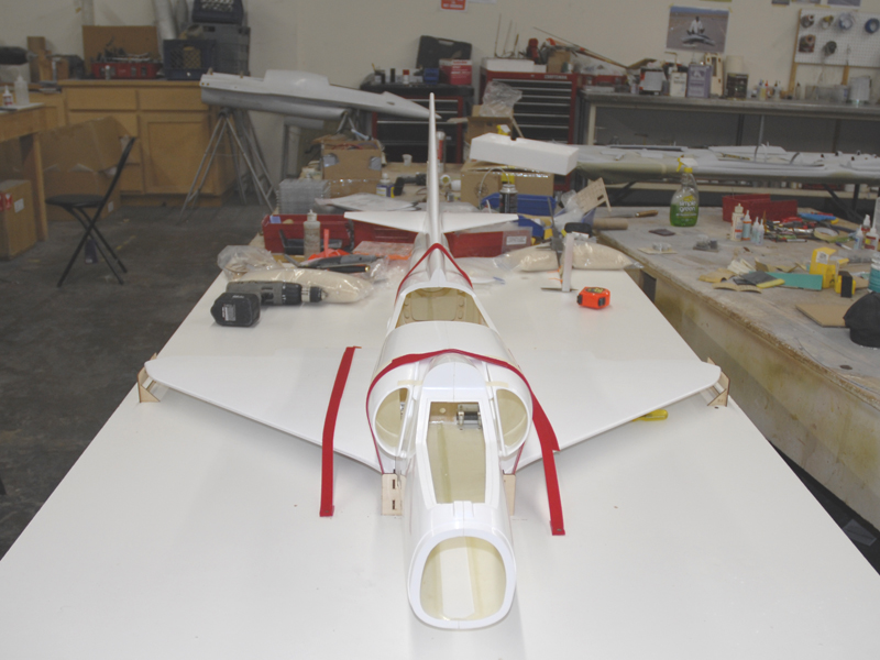

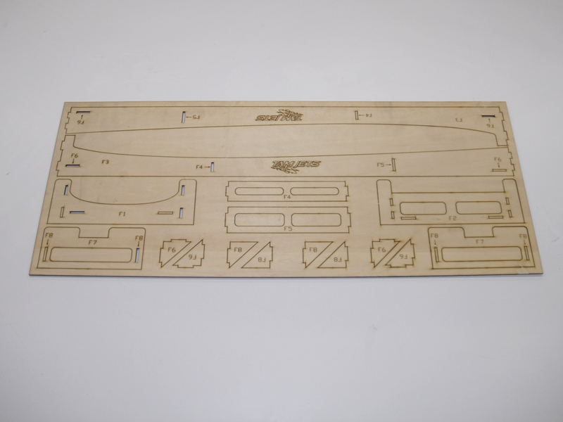

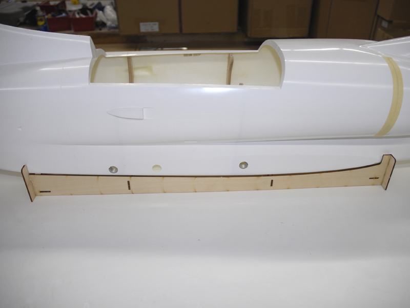

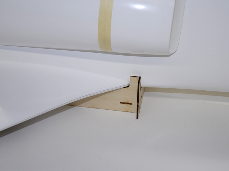

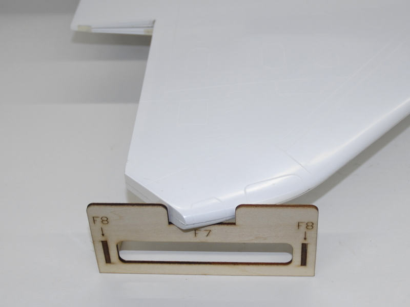

O.K guys.
Last week I promise to made the jig for easy assemble kit version.
Here it is. This jig is very accurate and it make the assemble in two hours job instead of all day try to get it alignment.

Old 11-20-2006 | 09:59 PM
  #80
My Feedback: (14)
Posts: 524
From: St. Mary\'s City, MD
Default RE: Tam's New A-4 Kit
Me thinks that would be called VALUE ADDED

Tam,
That jig setup looks great. I'm thinking an A4 would be the perfect birthday present to give myself!

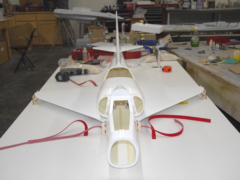

I use Jr 2721 or Jr 8411 for flaps, Jr 3421 for rudder,elevators, and ailerons.
Today I set up the jig to try out on Buck kit.
It came out perfect. I take the measure all around and only find one stab is higher than the other by 1/16". This could adjust on the final glue the stabs or left it along.
Jig is good to go.
