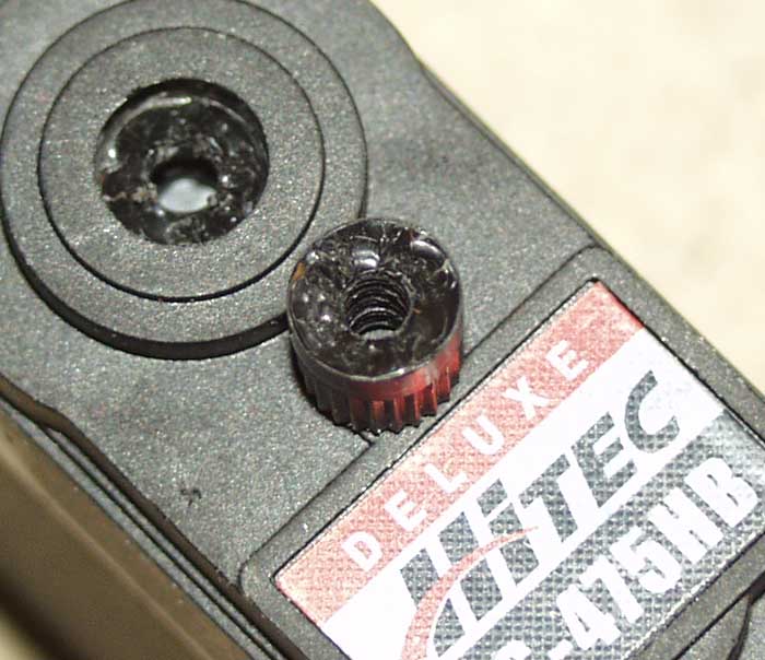

A longer screw is supposed to remedy that problem.
The Karbonite servos aren't recomended for big gassers but the lower vibration levels of jets may allow their use. The safest type is of course metal gears.

I got this from the sales manager at Hitec. Karbonite gear train servos should NOT be used in aircraft weighing over 12lbs. The longer screw helps but it is not a complete fix. Since turbine jets put even more stress on servos due to the high speeds I would not use them in ANY jet. I recently had a customer lose both aileron servos on takeoff of the maiden flight on a 27% Extra with the longer screws. These were the 6985 servos. The aircraft was thankfully recovered with minimal damage. Hitec replaced the servos with the 5985MG.
I talked with one of my customers who is an engineer dealing with plastics for a local printer manufacturer. He said they have experimented with this type of material and could never achieve consistent strength. It appears that Hitec is experiencing the same problem.
Please don't risk your airplane or injury to those around you. The 5645 servos are a metal gear train and customer feedback has been very positive at my store. If others have had a different experience with this servo I'm sure they'll explain.
This is not a slam on Hitec. About 90% of the servos my store sells are Hitec. They just whiffed on the Karbonite stuff at higher power levels. It seems to be a great material for the smaller servos like the HS-65.

Karbonite is definatley stronger than nylon (4 times per testing) but we have found that due to the hardness of the material that it can be more brittle causing it to shear in some situations. The 6985HB has actually been discontinued because the power to geartrain strength was not a good match. The 6975HB and 6965HB's are still available and shine in helicopter usage as the Karbonite holds up well there, even in heli's up to .90 size. We feel comfortable using Karbonite in high performacne models up to 12lbs utilizing one servo per control surface.
Note that the metal and titanium geared servos use what we can an M/K (metal, karbonite) gear as the first gear off the motor pinion. Most all other manufacturers use an all nylon gear here. The M/K gears have never stripped under normal conditions so there is no need to worry about its usage here.

It would seem that my contribution with my slow servos has expanded the discussion. I would value a comment from Mike Mayberry. Comments on the first output gear on metal gear trains being of a non metalic formulation is interesting. To say they never fail can in my opinion be challenged since I had two failures with Multiplex micro 'digi' servos where the motor output gear which appeared to be made of a fiber material just crumbled before the servos were even flown. I couldn't buy spare gear sets for these but the UK agent was prepared to replace these for an exhorbitant fee. I subsequently discovered that they had experienced problems with this gear. These were fitted to a large Peter Nye Grumman Panther. I believe that Multiplex and Hitech are one and the same manufacterer now. Once again I don't wish to knock anybody but merely to pass on my own experiences and try and learn more about servo performance.
Posts: 3,531
From: Poway, CA
Ron- I'm happy to comment. First of all... you state the output gear crumbled to dispute my claim, but yet I was referring to the first gear next to the motor pinion not the output gear.
I'm not sure what MPX servo you are referring to either as the Titan is the only digital servo with Karbonite gears.
However, it's been my experience that when the Karbonite output shaft crumbles like you describe that loctite had been used on the screw as it will attack the material.
