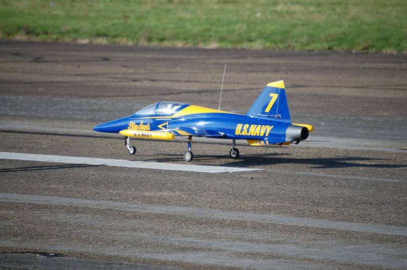

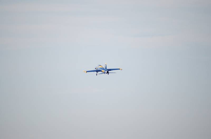

Guys
Just returned from a nice day at Chalgrove where several new models were test flown.
Trevor Skedge test flew his Comp ARF Flash (review model for RCJi)
Powered by a spare JetCat P80 his smile said it all after the first flight.
I'm sure he will chime in more info
