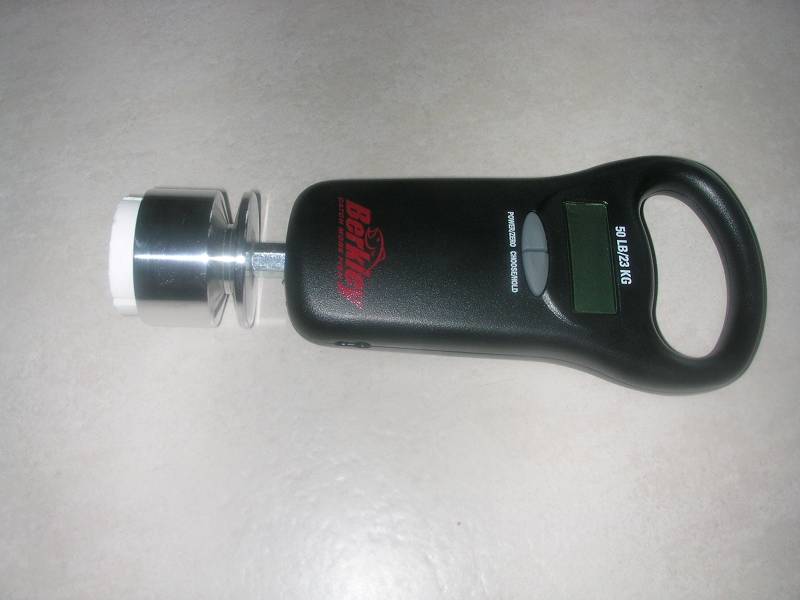

JASON THANKS FOR THE GREAT IDEA MY GAUGE WORKS GREAT.

So does mine!
I am making a few more for xmas presents!

we used ours this weekend.
Limeybob's Jetcat P-60 showed 12.4lbs thrust
I thought it would be more than that

This is a great idea. Has anyone checked one against a known force gage, or turned it up with a known weight on it, to see how accurate it is?

I checked mine using a known five pound weight on top of the cone. It measured a repeatable 4 lbs 15 oz to 5 lbs 1 oz several times.
That's close enough for me.
I will be using it as as a reference anyway. It's close, but no cigar.

Sounds pretty good, Harley. I'll have to get one
Anyone using this to measure force with the cone against the nose of a model should expect it to read less than the rated thrust of the engine due to tailpipe losses and frictional losses of the tires against the pavement.

Joeflyer,
You're right.
Frictional losses of the tires is called "sticksion".
We did this at work on a SWB turbine powered small UAV in about 1996 to get a more accurate reading. We used a load cell instead of a fish scale.
