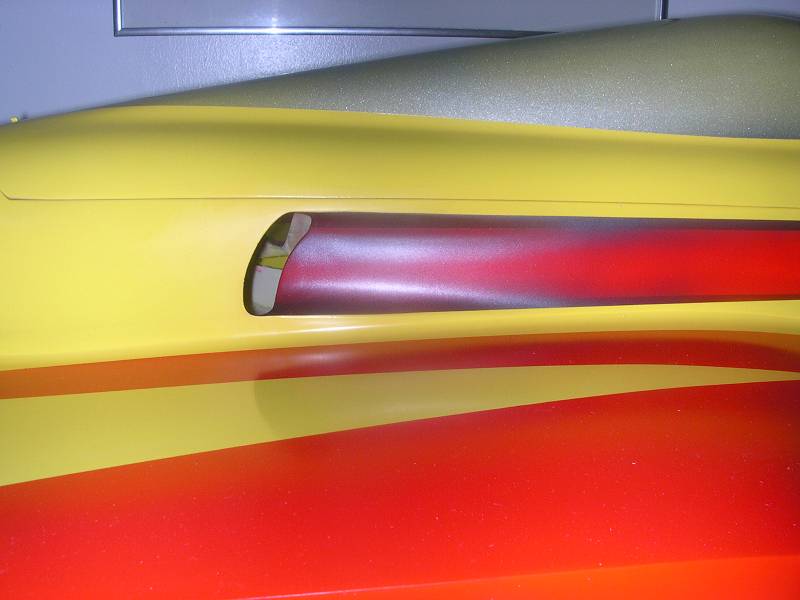

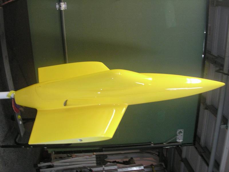

SCRATCH BUILT BY A FRIEND AND MYSELF, MINE IS MADE FOR A RAM 500 ,HIS WAS FLOWN AT FLORIDA JET WITH A RAM 1000 (VERY FAST) I MADE MINE 5LBS LIGHTER SO I COULD USE A SMALLER ENGINE
ABOUT THE SAME SIZE AS A BOB CAT .

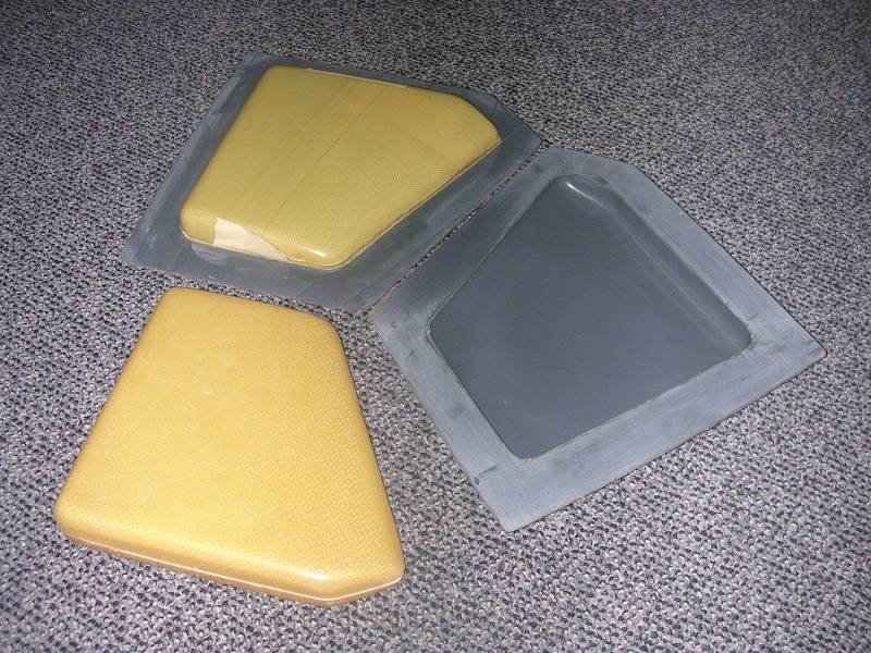

This type of work is very hard to do, congratulations, the product looks nearly flawless. Vacuum bagging is amazing isn't it?
How did you come up with the layout for the ribs inside the wings, if you don't mind me asking, and assuming they are there......
Old 11-26-2006 | 08:11 PM
Joined: Nov 2005
Posts: 69
From: CORAL SPRINGS, FL
Default RE: NEW PROJECT
WE MADE DOUBLE PARTS AND SLICED THEM INTO SECTION THEN MINUS THE SKIN THICKNESS PLUS
ROOM FOR GLUE (FOAM RIBS) LAYUP 1.4 2.0 2.0 3.0 1/16 BLUE FOAM .5 CARBON MAT VERY STRONG
AND LIGHT.
