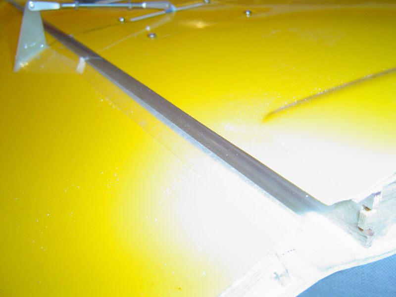

Its usualy not that large. I bet the previous owner sanded the gap larger, so the elevond did not bind.
Heres what I did on my kangaroo, and Eurosport.
I bought some Graupner Hinge tape, designed for high speed gliders. Its thicker than normal tape, and only stick on one half, and it curves slightly.
Perfect for this aplication, so nothing binds, and keeps the gap sealed.

I do the same thing with two layers of clear packing tape you can buy at anywhere....works great and never binds....Ron

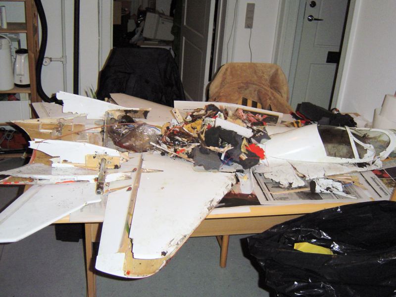

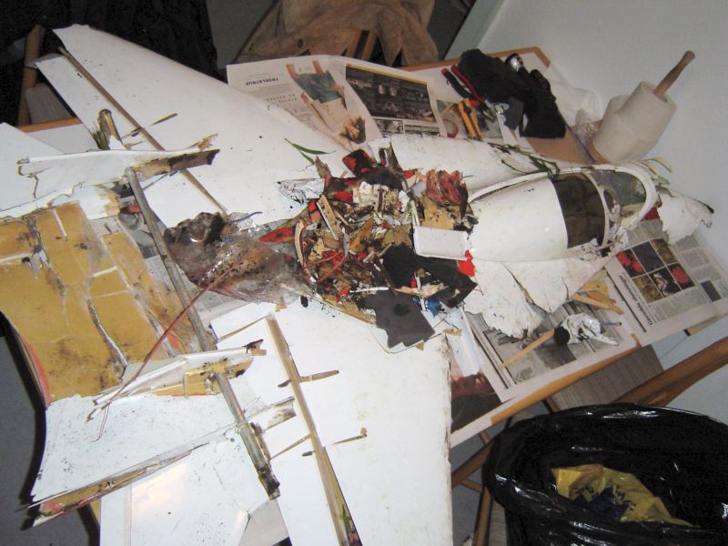

The Carf version is also hinged on the bottom like yours.
You can clearly see it in the pics of mine

Allthough it's some years ago now, I still remember how silent it was at the Falken field just after you crashed your Roo, Sonnich. That was the worst thing that could happen to a new jetpilot. Glad you're still into jets...
