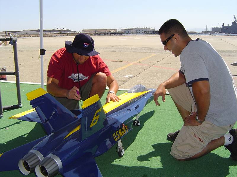

Maj Woody,
Attached is a pic of my SM f-18C which I eventually got rid of because I was having a really scary elevator issue. The person I sold it to was given full disclosure and I sent the third replacement stabs to him. See the attached post. I would TRIPLE check that the elevator issue has been taken care of....
She was gorgeous and I got one great flight out of her before I sold her...[&o] I flew her with a P-120 with out any problems. She had plenty of authority and tracked great. Careful with the ground handling.
http://www.rcuniverse.com/forum/m_48...tm.htm#4806202
I replaced it with the JL F-18c....
