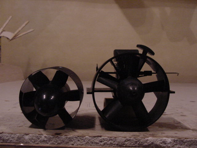

Hey Sig, you know after looking at some close up pictures on the EAM site that would be an awful small fit for the Toki. I wonder if John did a fuse for the RK-720 IC and another version for the e-power? Not much room is there?
Be interesting to see some pictures if KevinM can get them posted.
Fan on left is the HW-609 on Right is the Toki.

I've got the kit (and it's a great looking kit, by the way-even include styrene resin!) and there's easily enough room in it for the Kyosho fan (I got it before the Toki came around), however the ducting won't work as is.
The diameters are just too diferent. I was going to split the duct and add to it with a small strip of fiberglass down it's length. The thrust tube is area ruled, by the way and may be useable. The intakes would require a cheater hole, probably.
My impressions are that the kit is easily srtong, roomy and light enough. Anyone know how the Toki's getting tweaked to get near 3# thrust? Pipe length, fuel etc.?

Looks like I'm a bit late to say that the Toki won't really fit. John originally did his duct work on this plane wiht a Kyosho fan, which is 80mm. (Funny thing it fits so well, eh Chuck?
) Although there is only one kit, John has said that he could be coerced into "tweaking" the kit if someone has a specific request. (Note- tweaking, not redesign!) I've taken my photos with the K&B 3.5 in the foreground to provide some size comparison. I've got my white coat on the plane, but not yet had time to get the other colours on. (Story of a modeller's life!)

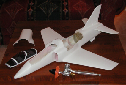

Here we are again with the hatches off. The hatches are designed to be rubber-banded in place from the inside. Quick, simple and light. (Oh yeah, cheap too!)

And here's the engine bay. There's just enough clearance for the head of the K&B, if I go that way. Not quite sure where I'll stick the fuel yet though. But I'll worry about that after I finish the paint. (I guess it's clear where my priorities lie!)
