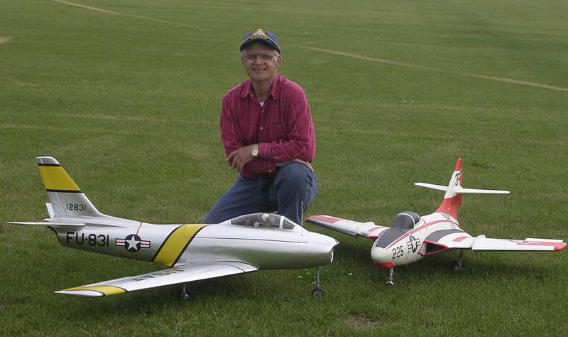

Hi Brian,
Going back to the old Sabre, hey. Is yours a Green or a Gold? I am using a double walled pipe, one of the 1st Wren type pipes Larry W made for his Sabres. More than 100 flights, occasional flames, never any heat damage to the fuse. I recommend it.
