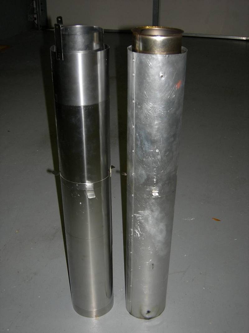

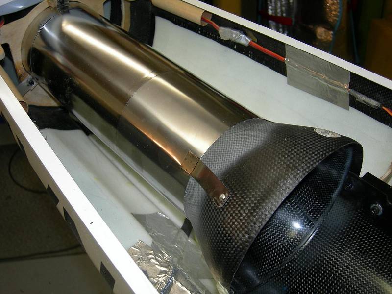

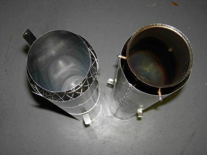

I got my pipe from Tam last August & I thought it was the only design for the Lightning - like the Eurosport pipe. Now I see yours & it's exactly like stock. Now you got me wondering if mine is for the larger turbines? Mine has a different flow design that is supposed to run cooler (all intake & exhaust thru center and aft fuse air thru the outer wall) I don't think it will, but I hope mine doesn't hurt the thrust on my Titan - Any ideas on that?
I had a 30mm difference from stock at the bell mouth. I shortened the aft end of my bypass & made thicker blocks for the mount tabs thus shifting the pipe forward so it exits the fuse at the stock length.

I want to clear any comfusing about three different pipes.
The large inside pipe goes over the bypass was made early last year. That pipe work very well for all class engine. It require to clear some of the wood former to fit the pipe.
The latest pipe made exact to the original stock pipe. But there is two different size. One is for 32-36 lbs thrust class. The other is for 36-45 lbs thrust class.
When order the exact duplicate to stock pipe. Please let me know how much thrust the engine you are using. So I can made to the correct size.
If you guys had one of the large pipe. That pipe work for any engine.
