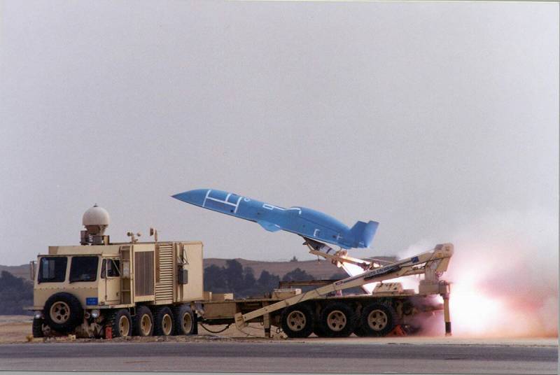

Attached is a photo of a Teledyne Ryan Aeronautical Model 324, now a Northrop Grumman product (since they bought us in 1999), that has a much larger booster that only burns for 4.5 seconds. The Model 324 goes from zero knots to booster burnout and jettison at 450 knots in 4.5 seconds! That's what makes me suspicious of the longer burn time figure given on TV. I also know that different propellant grains give different propulsion characteristics, but, I can't remember everything.
The zero length launcher/ground control segment and the launch-recovery vehicle are all that is required ot operate the RPV.
We built 56 of these medium range/altitude photo recon birds for the Arab Republic of Egypt Air Force in the eightys and nintys. I ended up as Chief Engineer on this program in 1999 until my retirement in 2005. From 99 on, it was a modification, provisioning and simulator training program. We have a dedicated Tech Rep in Cairo that operates/oversees the maintenance and other technical issues.
I went to Egypt in 2000 and 2001 for over a month to install and test fly an updated navigation system. What a blast!!. I took the photo that is attached.
