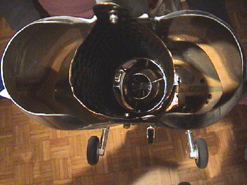

Default A/d Rafale
JPX powered A/d Rafale, there is no bypass, there is even no intake ducting (just 4 inches ) in order to save weight

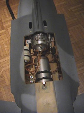

Default A/d Rafale
inside

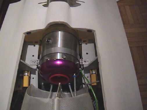

Default A/d Rafale
AMT powered, this one is like on the plan with the inlet ducting

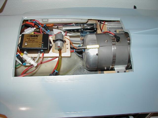

Charlie H.'s Avatar
My Feedback: (38)
Posts: 383
From: Spokane, WA
Default A/d Rafale
HI Tommy
I'm running a Ram 750 in mine with no bypass,works great !
Photo attached Charlie H.
