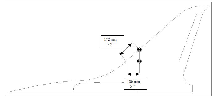

Does anyone know exactly where the best CG is on this jet? I have it balance at 5" from the root leading edge and it seems really nose heavy. I have been thinking of moving it back to 6"

you can start at 5, and then fine tune it to your taste. (picture from the manual)

i fly 3 times with that CG , and i think the CG need little back , but i dont have expirience with delta wings .

the second landing was pretty good, and based on the elevon deflection at touchdown I would say that you can give a try at 5 1/4 to 5 1/2 cg.
Don´t worry about landing with the mains first, and the nose well pointed up, this plane doesn´t drop a wing. you may add some extra exponential rate if you find the plane twichy at high speed using this new setting.

i set up the CG to 140mm for the next test , and i change the throws from ailerons 20mm to 15mm , elevator 20mm to 25mm.

I think you will fine.. take your time, and do one change at a time... the Storm is a great jet.

2 - i change the CG back 10mm from 130mm to 140mm , maybe i test it tomorow . ( you are see any diferent in landing , and how much moving the CG back ? )
