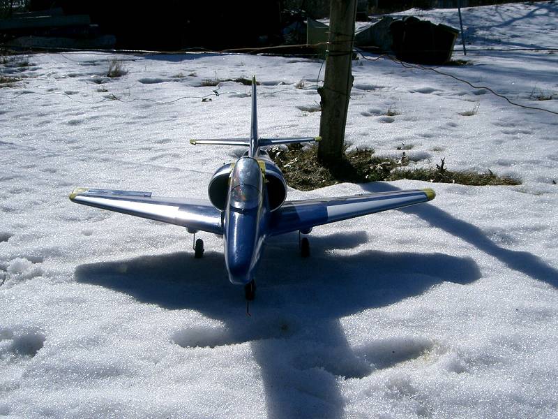

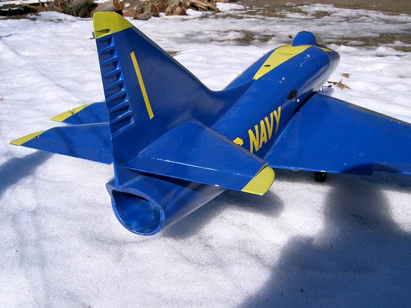

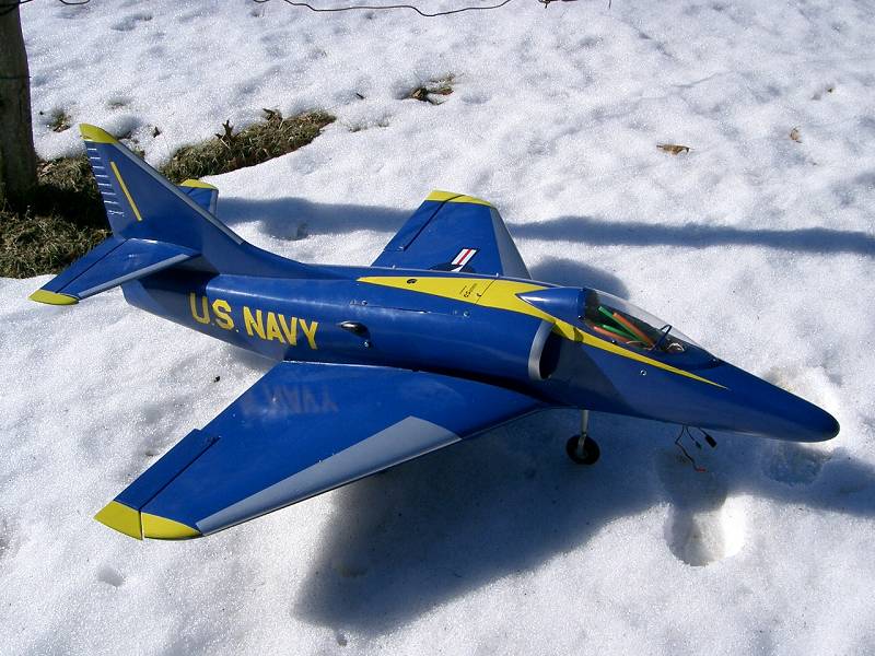

finally got the pictures . Still need a CG location if someone can give me one.

Hard to tell which kit it is from those pics, but just judging by the engine hatch and the exhaust outlet I would venture to guess that it is a Jet Hanger. It could still be an early Yellow AC kit though.
Pull the hatches and get some pics of the ducting.
Re: the fan and starter probe.
6mm is very close to 1/4". If that is indeed a Dynamax fan unit it should be a 1/4" hex. Make sure you use the correct size because they will round out very quickly if you don't. Always use a little lube on the starter probe as well to keep this from happening.

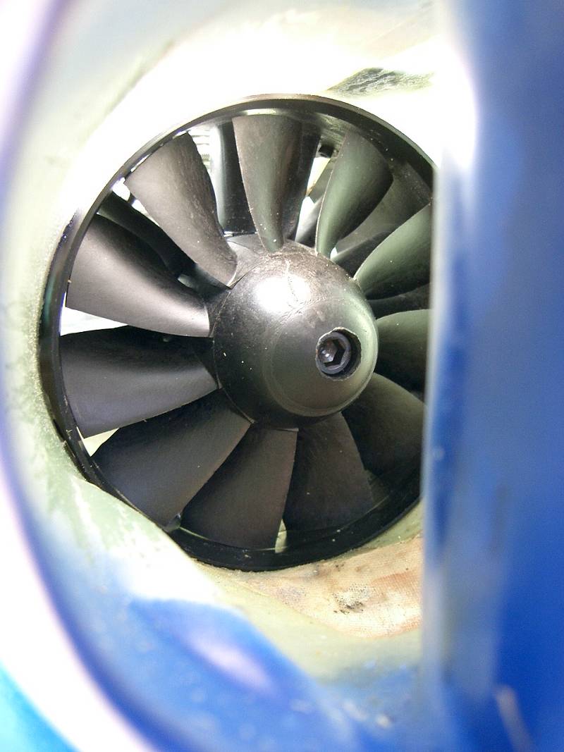

Will post some internal pics tomorrow. As far as the fan, hex is definately 6mm but i don't think the center bolt is original. The hole in the front of the spinner shows evidence of having been enlarged, and the person I got it from said something about having to replace the bolt. Haven't had a chance to make the probe yet but will be sure to use the lube when the time comes.

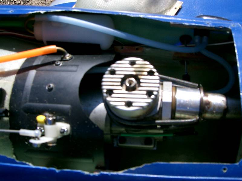

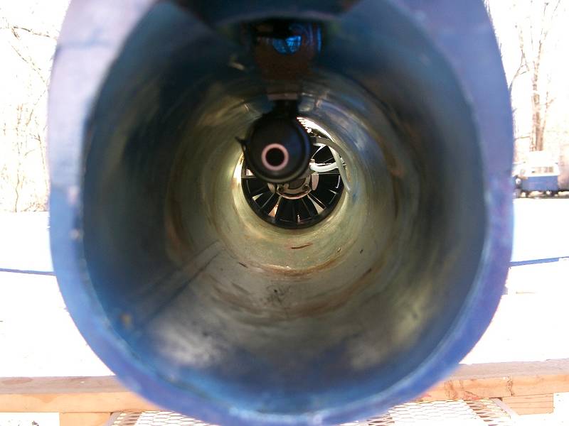

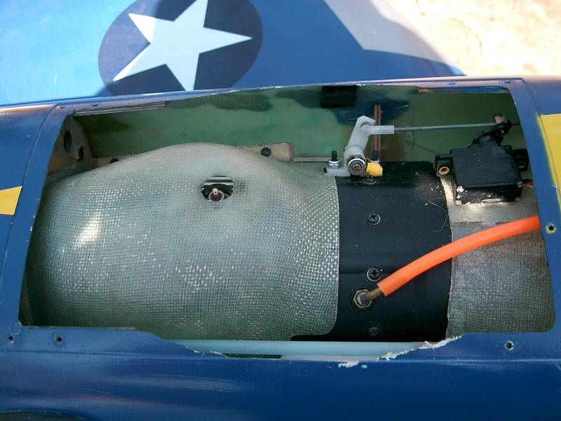

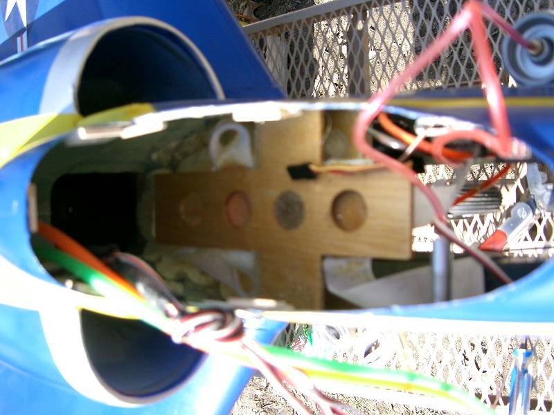

Here are the rest of the pics. Did everything but pull the fan again. Not too worried about the lack of rudder. May run up the engine this afternoon

Looks like a early Yellow Aircraft A-Fo to me.
You might want to PM Buck (Yeahbaby), he was flying one of those about 6 months ago and probably will be able to help you with CG and throws.
That damage in the spinner could have been caused by a probe slipping. Triple check to see if a 1/4" ball end allen will fit it. It is possible that someone changed it out, but they probably would have had to machine a new fan nut to make it work with a metric bolt. I think it is very unlikely that someone would go to that much trouble.

11 blades,,, about positive its a dynamax, as for the fan pressure I wouldnt reconmend that, i would go with pipe pressure.

That's definitely an old Yellow A-4. Kevin is quite correct about the bolt. The 6mm will fit, and even seem snug, but don't spin that unless you're 100% certain the 1/4" one won't fit even better. Otherwise, you'll hog out the bolt with your heli starter (ask me how I know).
As for CG, it's important to know whether you have the scale or sport wing. Can you measure the span?
