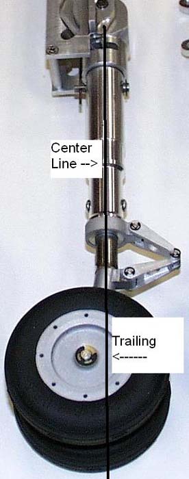

HI guys, thanks for all your info, good thing I asked. Here is a pic of what I beleive you all are refering to.

Why didn't you just say so in the first place. I've been flying that plane you showed in your picture for the past couple years now. The nose gear works fine. You can bend anything if you smack the ground hard enough. That strut is a tough unit, it can take some abuse. If it does bend, well bend it back, and go fly again.

Hi six shooter, sorry but I don't have the strut in the picture, which comes from a f100. I got it from BVM's site. Yup I can believe this is the most damaged part of the aircraft. Depending on different surfaces. I am putting this on a Mirage 4000, Turbine version, with a KJ66 GB auto electric start. Going to talk to BVM this morning to see if he could sell me the nose strut and wheels he has for the f100. Looks like a perfect match for me, if the sizes fit tho, eg: lenght of strut and the wheels are nomare than 2 1/8 inches. thanks........Paul
