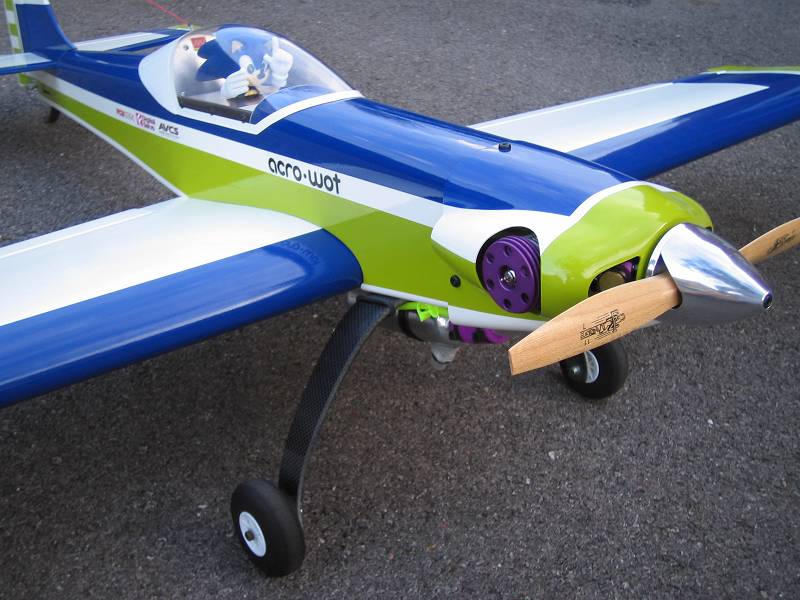

Zain,
As the other said just use standard precautions, and a decent mask. I am no pro but painted a prop plane a year or so ago and the results were very good. Use a 1mm needle and things should be fine, the finish is very durable and very hard - best of luck.
Just one note on the application, as it is a 2 part system once the paint applied has gone hard you need to really scuff the surface if you need to apply further coats, ideally apply as many coats as needed to get the cover and finish, leaving only around 10-15 minutes for the paint to 'flash off' between coats, then when everything is really dry cut it back with very fine wet and dry and polish up to the final finish.
