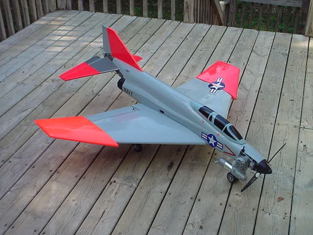

Hey, Strykaas
I have an F-4 build thread over at Scratchbuilding. I had a Tower 75 on it that pooped out, so I stuck a Magnum 91 on it. If anything, the Phantom is bigger and heavier than the AK Su-27. I'll try to let you know how it flys. I have a Magnum 91 4S and it has be my best engine ever.
Gotta wait until I can afford brakes before I try it. 350' paved runway with a nasty overrun.

I just installed an 0S 91FX on my Phantom, which replaced the Magnum, which replaced the Tower.
If it runs anything like what I've heard, I'll be using one on my AK when I finally get around to building it.

teebox:
Which F-4 is the "TF"? (Mine is built from Pavel Bosak's plans, circa 1990) He used a piped Rossi 60. I thought a larger, less exotic engine would deliver the same performance with less stress.
BTW, I started breaking in the OS 91FX today, and it is a real sweetheart. Started on the first hit and never missed a beat, unlike both the Tower and the Magnum, which were cranky about starting and couldn't handle the jumper tank fuel system. (The OS will go vertical with no loss of rpm. The Tower and the Magnum couldn't do that.)
