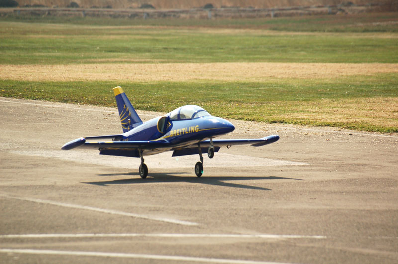

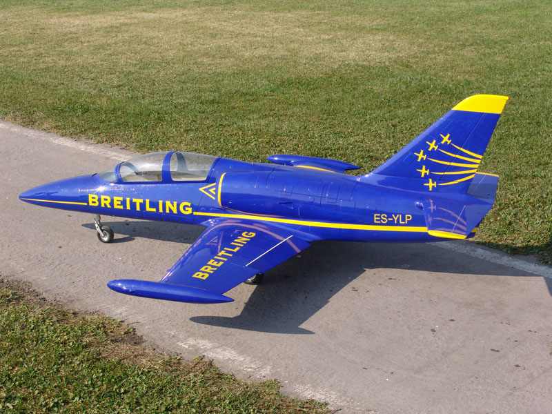

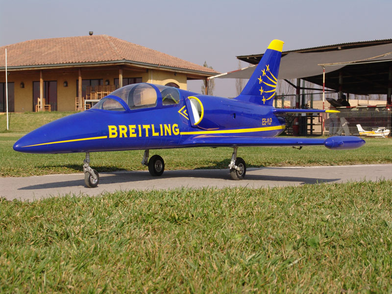

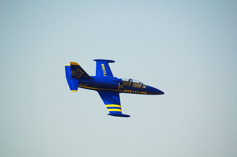

Hi guys, I did the maiden on the Skymaster L-39 for a customer. This one was powered by a Jet Central Falcon, producing 23lbs of thrust. All I can say is WOW... The L-39 fly's awesome, very stable and the Falcon gave it more than enough power. Only half throttle was used for regular flight.
Takeoff was very easy and smooth.
Flight was very predictable and the jet was very easy to fly. I was impressed on how slow this jet can fly...
Landing was as easy as all the rest of the flight, it does float a lot so you need to loose speed before getting to final. When on the floor be nice on the brakes to keep it stable.
Well no more words and some action... Check the video...

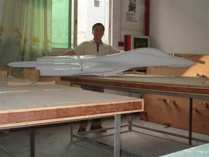

Hi, Michel
when you get the ARF PLUS Su-27 that you will stand at the end of runway for take-off ........

Looking very nice! Do you have any specs for this jet or know when it will be available?

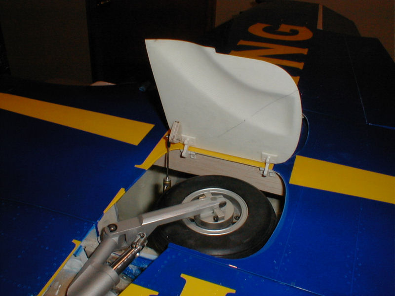

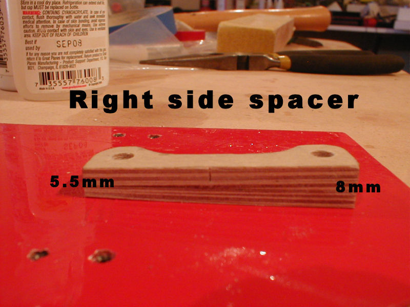

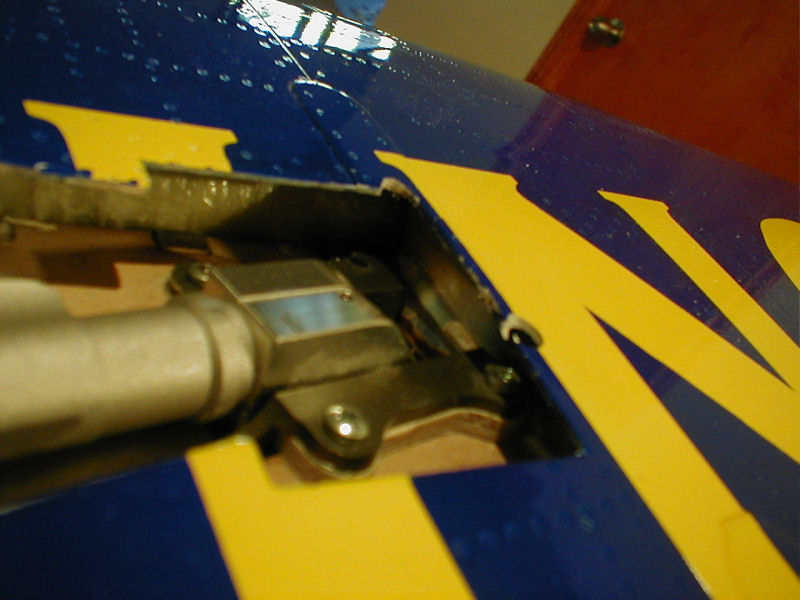

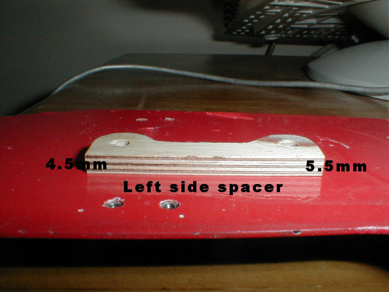

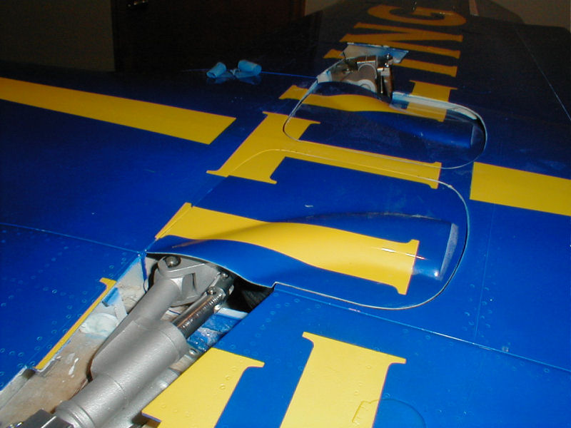

Hey Michel; How much fuel does it have and do the wheels fit in wheel well properly? I am very interested in the blue one, but awaiting funds from selling one of my motorcycles[&:]

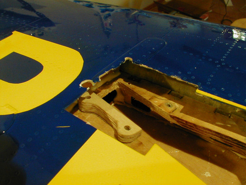

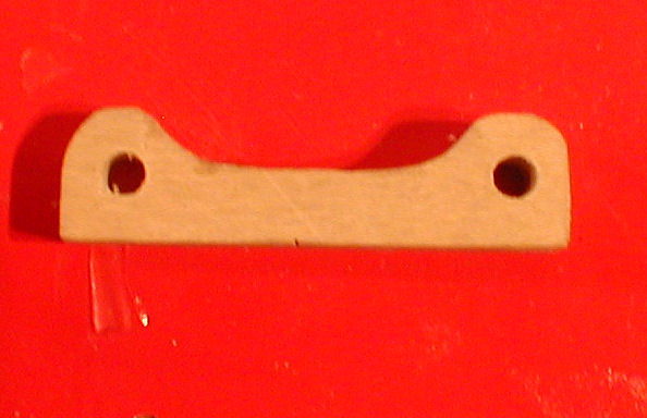

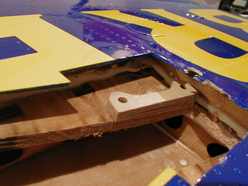

The wheels fit is very tight and you must not overinflate the tires. Our builder made some moldifications to the gear mounts in order to get the wheels and doors fit. This modification will be included in the future by the factory.
I will get back to you oin the tanks... Don't remember how much fuel they can take...[X(]
By the way all was set as factory specs...CG and throws...

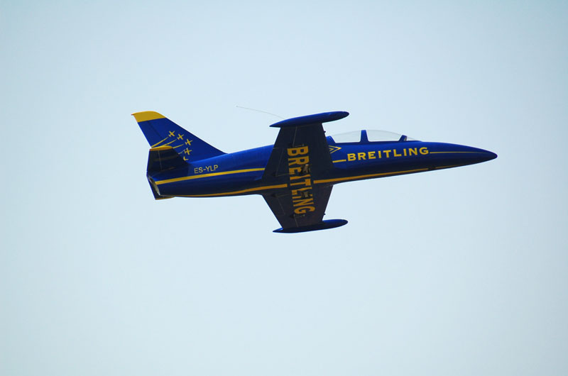

A few more pics....

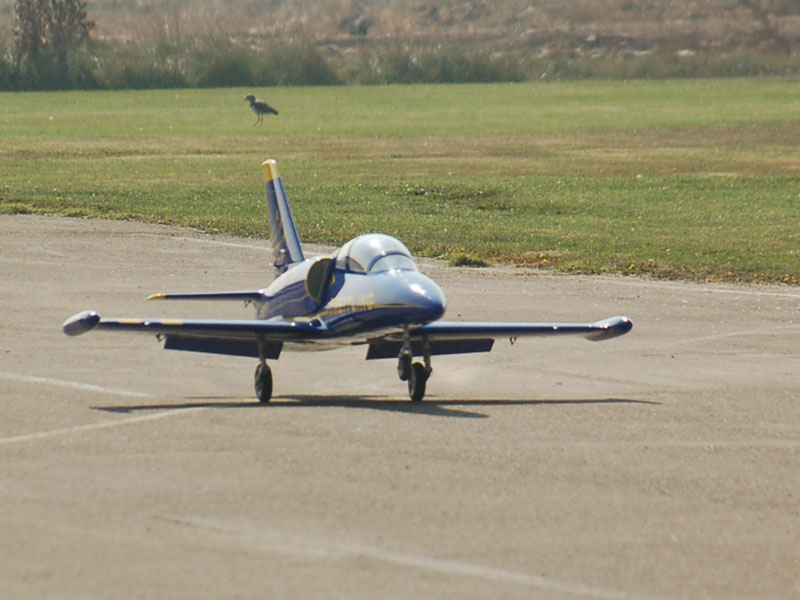

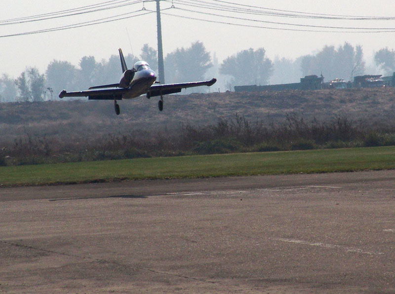

Looking great on touch down!! May be you can teach me how to land when we visit you..
I am impressed that a 23 lb turbine can fly this large jet that well!!!

What kind of a bird is in the background??? He is not afraid of jets?

Believe me the L-39 is extremelly easy to land, I was impressed on how stable and slow this jet can aproach.
Birds are used to turebines by know... Not impressed at all...

Sorry , this is our secret for the size..., and this is a prototype, when we finished the test flihgt ,we will ake the scale Hydraulic L/G with scale cockpit details for su-27, and we still have no the release date,
