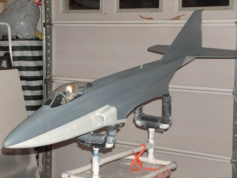

I would agree with this. I just painted this jet in latex with poly top coat, spraying it on with 3 different spray guns hooked up to about 40-60psi air hose. I didn't use any thinner. And based on the amount of paint left in the cans and considering the amount of water in the paint that cures out, the weight gain is very very small. Read the whole story here: http://www.rcuniverse.com/forum/m_5825995/tm.htm
Jroth, the gloss clear polycrylic I used is not 91% alcohol proof, it smudges the gloss finish bad. Windex works fine however.

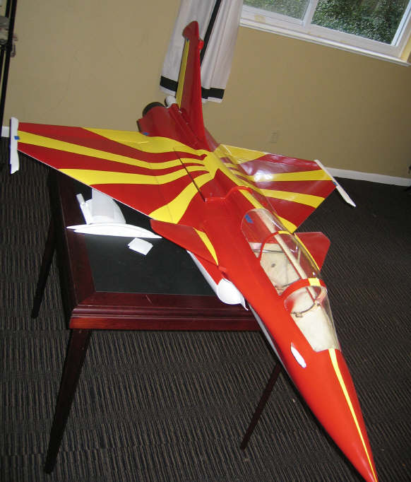

I will second the "Warbird Colors" good experience. It isn't Latex, but it is water based and it is fuel proof. I've sprayed latex before and I have to say I prefer the WarbirdColors paint application process. It is a polyurethane of sorts and sprays like an acrylic, working best with HVLP guns.
I just glassed and painted a P-60 powered jet with it. It dries hard and can be masked and worked with in an hour or two. From what I can tell, it isn't much if any heavier than any other paint except possibly a lacquer based paint - those are nearly impossible to beat for lightness. But I can almost guarantee it's a lot lighter than other epoxy based paints.
I would agree that latex could possibly be tricky with paint seams. Not so much so with the Warbird colors, relatively speaking. If you are repairing an area it is best done by masking off a "panel" area and then sanding with 1500 and 2000 grit, and clear coating over the seam area. I've already done this when fixing a couple mistake areas and it's worked. Be sure to prime under the paint, it needs something to stick to. High quality, relatively light weight lacquer primer bought from an auto paint shop (in a can) under the paint works like a champ.

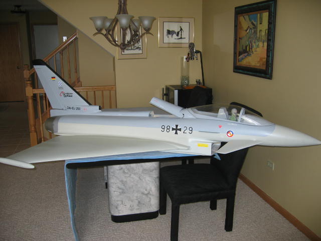

Krylon H2O laytex "Rattle" cans is what I used (white) covers in one coat, other colors are Testors Model Masters acrlyic

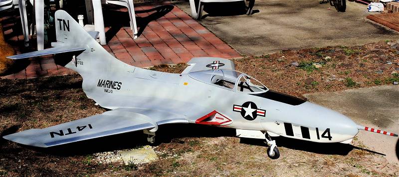

Attached is a photo of my F-100F painted with Polly S and clear coated with flat lacquer. For a first time user of this type paint on a large model, I was happy with the results. I am an old K&B guy.....so this is a new world for me. Time will tell on the durability, but I am sure it will not be as durable as K&B. Nothing is! On the plus side, it is much cheaper. There is about 40.00 worth of paint on the model. It is much easier to work with on mixing, shading, blending, touching up, etc.
