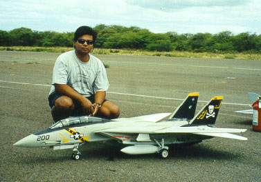

Hi Raf
Ditto what Adil said pretty much with some additions.
1. In the sweep back mode the roll is much less dampened and after you stop giving aileron it will have some roll momentum, and due to the wings being swept in now there will be little dampening of the roll input. Not a big deal just kinda feels looser and it will of course overshoot roll a little. We put a roll gyro to help solve this, and Futaba used to make a dual output gyro, but had since discontinued it.
2. Adil's F-14 is awesome but I have no Idea how he see's that thing when he fly’s. One good pilot with good eyes I guess, I had a Black Hawk and loved how it looked but I’m not making any more black planes if I can help it. They are just very hard for orientation in the Sky.
3. Make sure that the wings sweep back and forth pretty fast. Scale speed is cool until you get into trouble and you need those wings out.
4. Depending on how it is pivoted the wings should swing fwd in flight if you did not have anything connected to them, so most of the load is going fwd not back like you would expect. I think that this is due to the center of pressure of the wing being beind the pivot point. (at least in the Jetmart version)
5. Drop tanks add to the visibility and aid orientation. Make great skids if you landing gear has issues too.
6. One weird thing too at least with the DCU / Jetmart version. The fuselage lift is amazing, as you speed up you have to add tons of down trim to keep the aircraft level! In fact when you look at the elevator at neutral for normal flight the leading edge is 1/8" up from level! We saw this on 2 DF versions and Bills turbine version.
7. Jetmart version did not have flap's just a clean wing. Really did not seem to need them though, during landing the plane seemed to have enough drag to land well.
8. Extreme jealousy, you are making me green with envy sir! [:'(] Just kidding, just make sure you post some pics when you can !!!!
I had the old DCU kit which is now the Jetmart Kit. I flew mine DF OS .91's with Dynamaxes. I also helped my friend Bill with his, that was Super Bee powered. Pics are of my friend John C.'s F-14. The black one is Adils I beleive.
