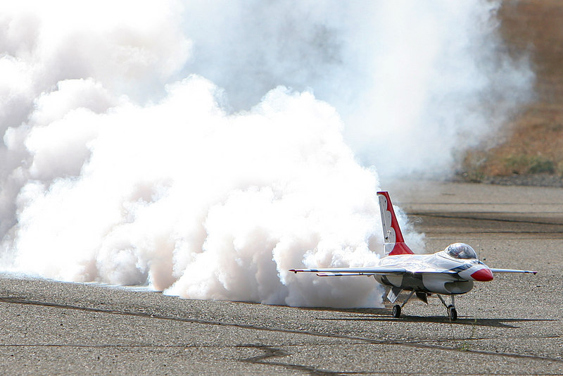

Hello guys,
I'd like to make my own smoke pump setup for a couple of jets.
I bought some SS tubes 1/8" ID, and i have a Sullivan Skywriter smoke pump with a small 7.4V lipo.
A few things i want to know:
1. why is everyone using 2 injector tubes ? isnt 1 enough ?
2. the crimp in the end of the tubes, whats the width of the slot i need to leave open ?
3. do you use the full pumping power of the pump (its variable from theTx of course) ?
Any tips would be welcome.
thanks.

smash tube end with sliver of soda can in slot, then pull it out when tight.. try 1 tube and low pump speed, if it doesn't work good then try 2... seems guys get different results with 1 or 2 tubes some like 1 some like 2... lots of info here on smoke systems, do a search..

If you want to roll your own, you will likely end up with a lot of splattered smoke oil on the floor and a lot of trashed SS tubing in the garbage.... Just spend the 15 bux and get a ready made tube (or 2) from Tam.... I tried various methods of creating the nozzles but nothing works as well as a store bought tube.
the skywriter pump works great...
The photo below is with the sullivan pump on 5 cell nicd and a single tube.....

Wayne22, that looks like A LOT of smoke - if you get so much on a single tube why use more than one ?
A few things i would love to know from you:
1. Can i see pics of the installation (pump and tank) in your F-16 ? i want to put one in my F-16 as well (Cermark\Tamjets - i think the same plane as yours).
2. does it matter where you inject the fluid into the flow of the turbine EG ? from which angle or how deep in the flow ?
3. how long should the injector tubes be ? i mean.. how long should they protrude over the front of the turbine ? i guess they should be long enough that the front edge of the tube wont heat up and burn the tygon tubing that delievers the smoke fluid...

Thanks, but there is a little bit of magic there...the 16 is just taxiing and the engine is at idle, so the smoke has nowhere to go...it looked pretty spectacular though..... If you want to see it in the air, here's a vid...
http://www.youtube.com/watch?v=24a-Qc2uqiA
...sorry but the F-16 is all in pieces now..I haven't had time to get it in the air this year. I mounted a sullivan boat tank in the turtle deck behind the canopy...the smoke pump is buried down below there somewhere......
I've got it a couple of inches behind the exhaust nozzle and angled well into the exhaust stream
I used Tam's excellent smoke injector tubes..they include a fixed mounting tab that slides under the rear mounting straps for the turbine.....that fixes the length of the tube behind the mounting strap. There is a sliding tab on the front of the tube that slips under the front Turbine mounting strap..so it is adjustable for many types of engines. No problem with Tygon getting too hot.
