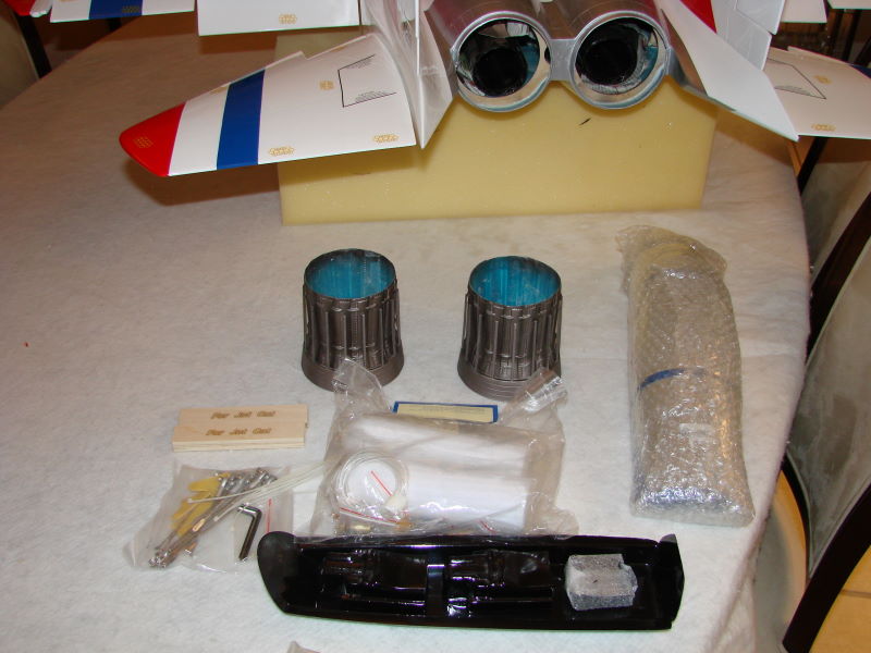

You guys with Skymaster, JetLegend, FEI Bao, Xtreme Jets, F-15's....what are you using for servos on the rudders and elevators?
I'm thinking 8411's at 6v for elevators, what about the rudders? What fits?

Hi Ronnie,
Here goes one of possible servo set up.
F-15 SERVOS
AILERON : DS.3421
FLAP. 8611
Elev. 8611
RUDDER. DS168
Achilles.

I would recommend 8611 or 8711, because of elevator´s size and travel.
Achilles.
