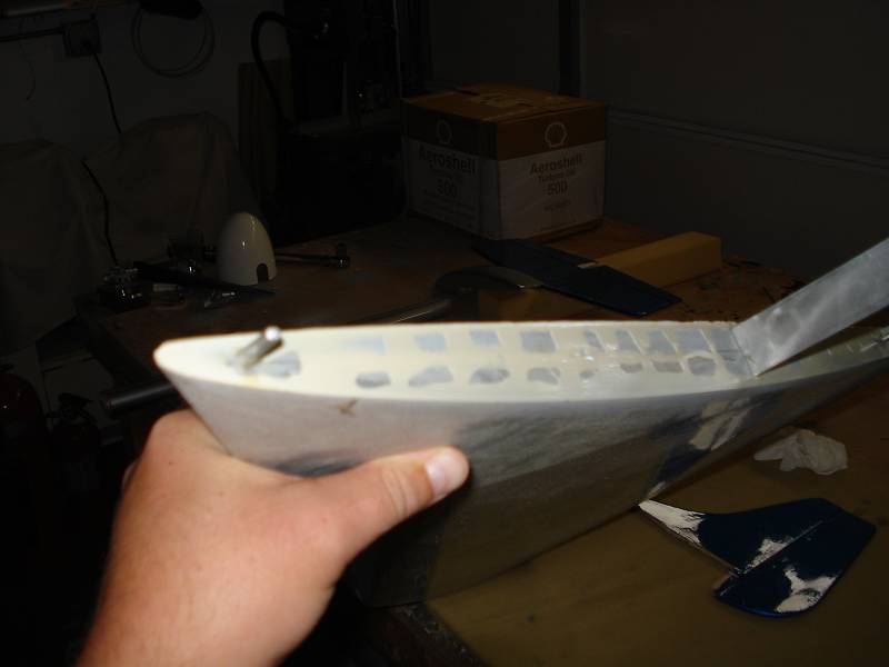

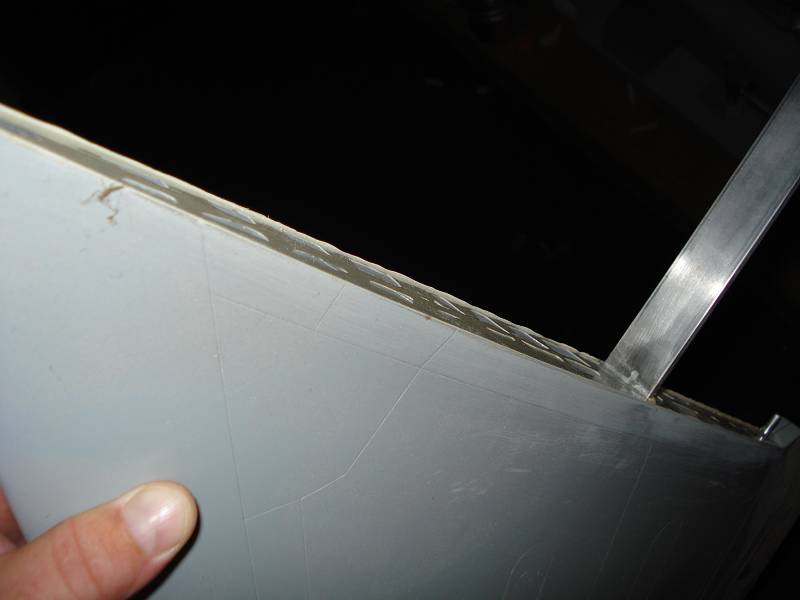

I have used Hysol. After protecting one side with food wrap, I layed a bead down of 9462 and pressed the wing in. After it dries you can sand to a real sharp edge. The Hysol is alot stronger than filler and won't chip as easily.
