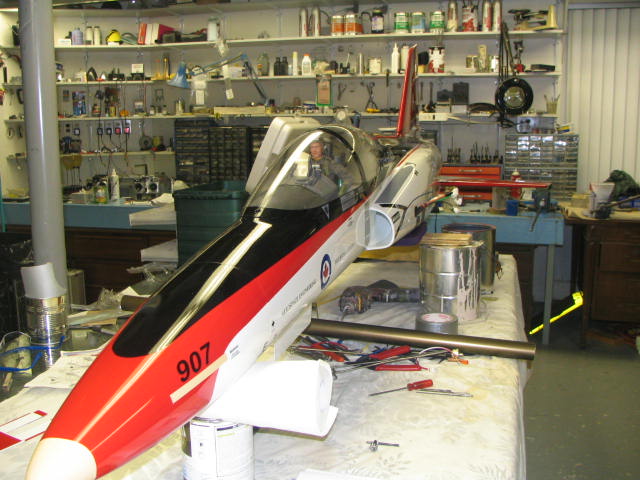

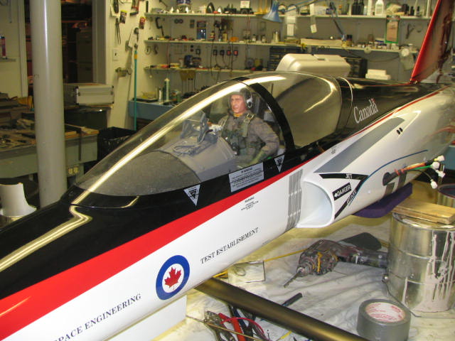

HI all, knowing the Lightning is usually tail heavy, I built a bridge in the nose to carry all the batteries. I balanced the lightning tonight and it"s 2 3/4'' in front of the center of the wing tube, a little nose heavy. Question, should I move the CG to 2'' or do the first flight at 2 3/4''.

Pete, The Lightning likes to be a little nose heavy. Keep it there and evaluate after a few flights. WHMC STL

HI, thanks guys, I"ll try the first flight at 2 3/4'' and see what happens.

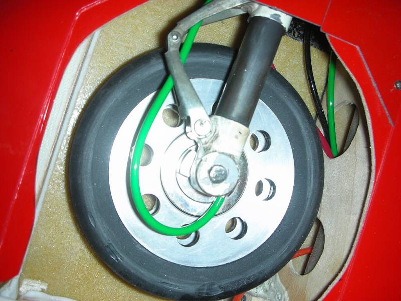

I'm saving the pictures for Waco Jet rally. We really accomplished something cool here, and I want to make a new thread of it.
I can tell you this without any reservation. YOU CAN NOT LIGHTEN THE WHEELS!
THE WEIGHT IS IN THE TIRE, NOT THE RIM!
How do I know for sure? Here's a hint:

We CNC'd them. The rim is hollow, and I got lucky on the dimensions, I was within .002 of having an aesthetic problem. When you see the other side of this RIM, you are going to want to send me your wheels and have these holes put in your wheels. I think all Lightning guys are gonna want to do this.
There is no slop at all in the Retracts/ Struts/ Brakes now.
