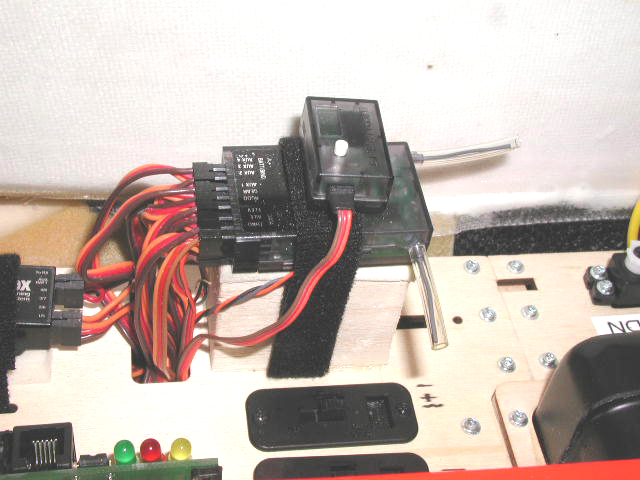

Would someone show a pic of the antenna mod being talked about. I just got my 9303 2.4 yesterday. Thanks, Jim
Old 09-02-2007 | 08:34 PM
rcguy!'s Avatar
My Feedback: (69)
Posts: 2,859
From: Chesterland , OH
Default RE: tips on 9303 spread spectrum

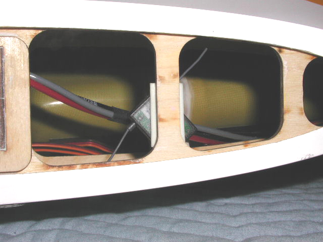

Pics below are from my AR9000 RX in my KingCat
http://www.rcuniverse.com/forum/m_60..._1/key_/tm.htm

Thank you for the pic rcguy. I also looked and read the link. very good info there too. Thanks again, Jim

go to the DX7 read file. You will find a zillion lessons learned on the receiver. plenty of pics. The system rocks when and only when it is set up right.
it is more sensitive to low voltage below 4. make sure you have very robust power delivery with big servos, so the voltage doesn't drop.
The rx can handle 30 amps and 9 volts. make sure you make the mod to the ar9000 though. see website. I dont recommend putting aerial over the antennas. just put a dab of silicone on the case where they come out. The aerial tubing adds stress to the antenna mount. see my pics in dxy or go to aerobob's website. RCaerobats.com.
If done right, you will love it.
by the way, sweet nice install, like the elevated receiver. gets it above the ECU. very nice. long leads too. you will probably be able to fly that a mile away.
