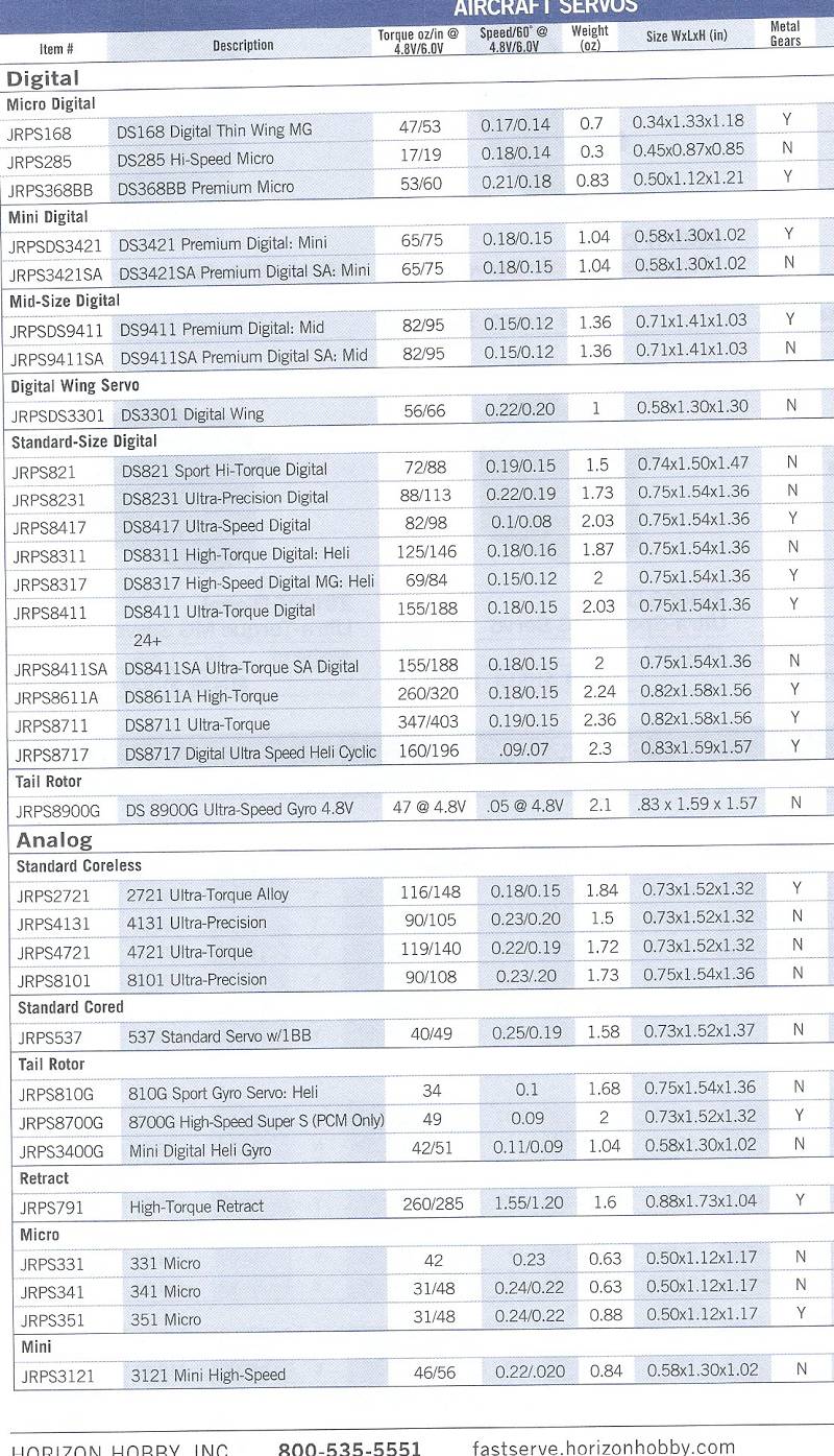

I've given up trying to find info easily on Horizon's website. I have seen a chart somewhere, that in one simple table shows all of the servos available togther with their dimensions, torque, etc. - but I don't recall whether I saw it online or in hardcopy somewhere.
Does anyone know where I can find such a beast ?
I'm trying to locate a JR servo that's at least 75 oz/in @ 6v, but no wider than 17mm. (For ailerons on my latest project, the CG Jaguar).

Hi Gordon,
Pulled from the latest Horizon product catalog.... Hope it helps....

Thanks everyone for the help. Looks like the trusty old 3421 is about the only one that matches.
