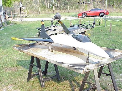

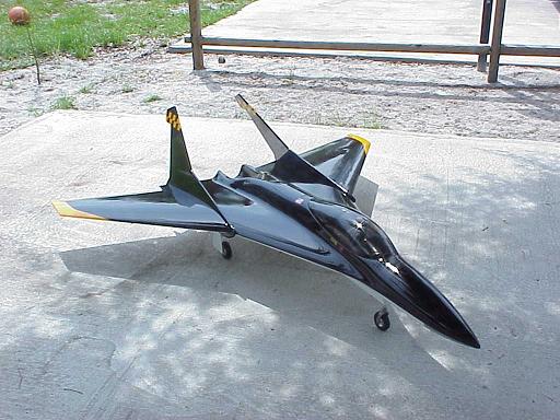

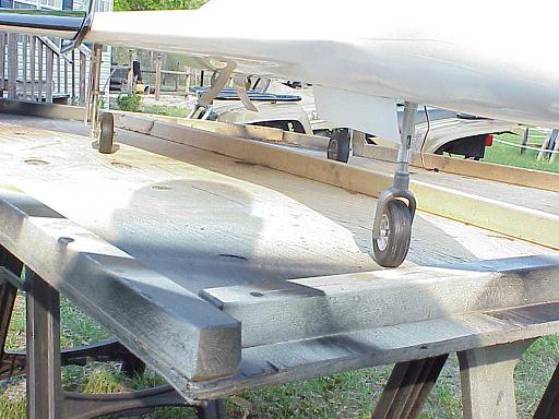

Here is the Hotspot as I am almost done with her. I should have it fully painted by this weekend and it will be ready for some test flights the following weekend here are some progress pictures.
Dave

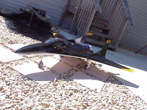

Todd doesn't look like the spot will be ready for her madien for this weekend but she is close...

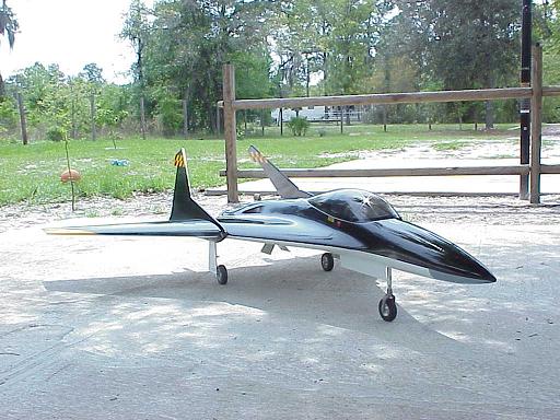

the regulators have been on back order since last week from minihobby It knew someone else carried them I would have it ready sooner.

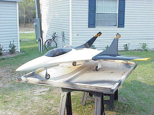

Rob, here it is at this stage all I have to do now is put on the rudders and balancing then some testing... also Rob here is what I have in it...
Todd, You coming out this weekend to fly. I am just waiting on the battery. I got my regulator yesterday and installed. she is about done.
Hotspot
Simjet 3000
Hitech digital servos all through out plane
Euro Retracts, wheels, and breaks
2 air tanks one for retracts and the other for wheel breaks and speed break.
Gear Doors
Gear Door Computer from Mini hobby
2 Mini hobby break valves
1 Mini hobby gear valve
3 HiTech HS81 on the doors.
2 saddle tanks and BVM Air trap tank = hold a gal of fuel
Mini hobby 5V regulator
Radio is Futaba 9CAP
