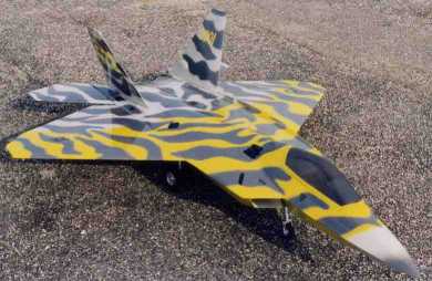

Old 03-22-2003 | 11:08 PM
Joined: Jun 2002
Posts: 460
From: Granby, QC, CANADA
Default F22 raptor
I also like the F22 from Christen Diffusion, take a look at his website.

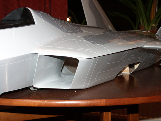

Old 03-23-2003 | 08:09 PM
weasel33's Avatar
Posts: 858
From: Morecambe, UNITED KINGDOM
Default FA 22
Detail on Christen Diffusion Raptor fuselage.
This is the ARF model with all formers fitted in a composite fus
Hi Kelly how are the english instructions coming along

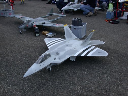

I-NAV's Avatar
Posts: 616
From: Mililani, HI
Default FA22 Raptor??
If you,ve got it down to 16" go fly. Mine moves more but I've had no trouble with it. As long as the stabs are mass ballanced you will be fine.

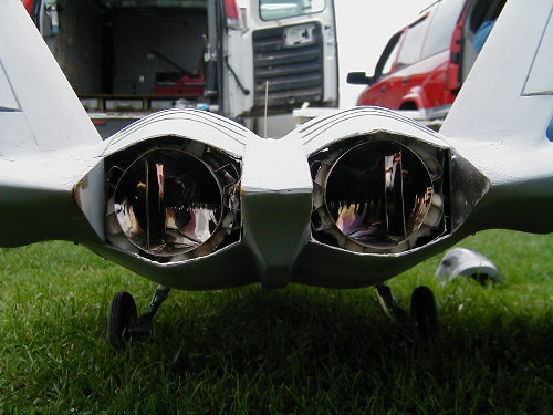

Old 03-29-2003 | 07:49 AM
I-NAV's Avatar
Posts: 616
From: Mililani, HI
Rc-Man,
Carefull with that single-walled pipe. Mine got hot and the top rear fuse began to sag at idle. Quick thinking by my dad saved the day. He shoved a leaf blower in the hatch and blew it back into shape. Only damage was the blister in the pic. It got hot at the split area of the pipe. I replaced mine with a double walled unit.
Mike
