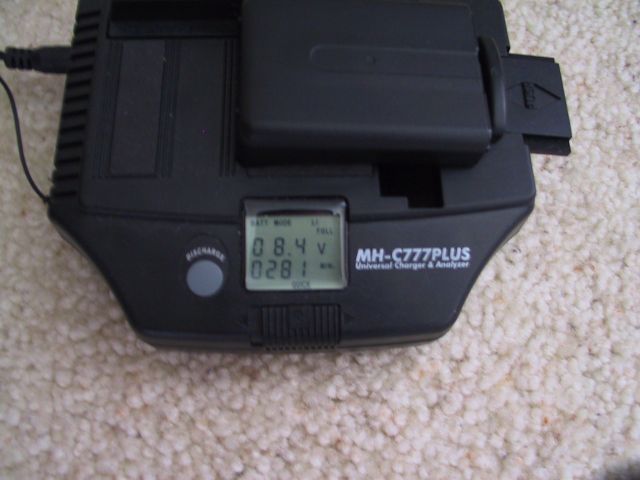

Good points john! BTW....Emory and I had the same discussion about Gary and the lithiums. The cells I am using are li-ion not the poly's (yet). There ARE cells coming that will give nicads a run for the money. There is one fault in your #'s above. The cells I am currently using are 4.2 volts, giving me a pack voltage of 8.4 so...
(3600*8.4)/$90 = 336 MahV/$

Most CVCC chargers are set to 4.2/8.4v for Li-ion cell(s). The cells come off the charger at 8.4v, but are rated at 3.7v/7.4/cell(s). I have never seen a 4.2v Li-Ion, but depending on chemistry, I have seen 3.0, 3.6, 3.7, and 3.8v cells.. As opposed to nicads and NiMh which lose that surface charge rapidly, Li's hold onto it for days, even weeks in my experience. The photo is of one of my 7.4/1550 packs that is fully charged and floating at 8.4v.
