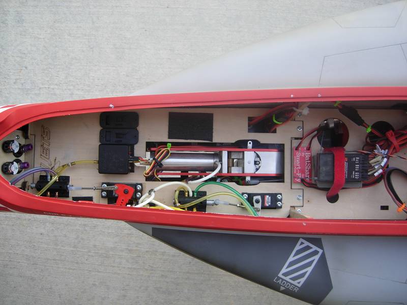

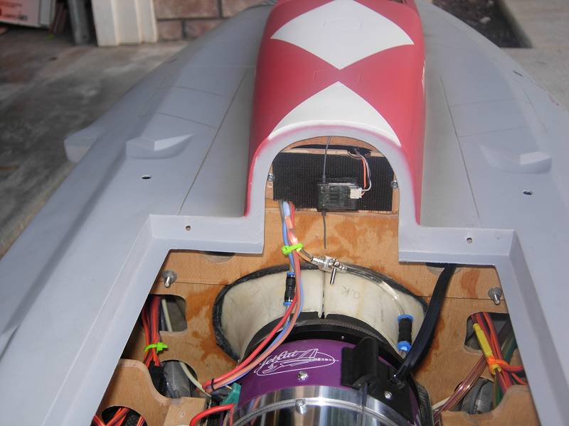

My setup:
Two JR 6v 5cell ni-cad 1800mah packs
Two JR switches
Bat-share
Power consumption= 300mah per 8 minute flight
