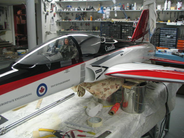

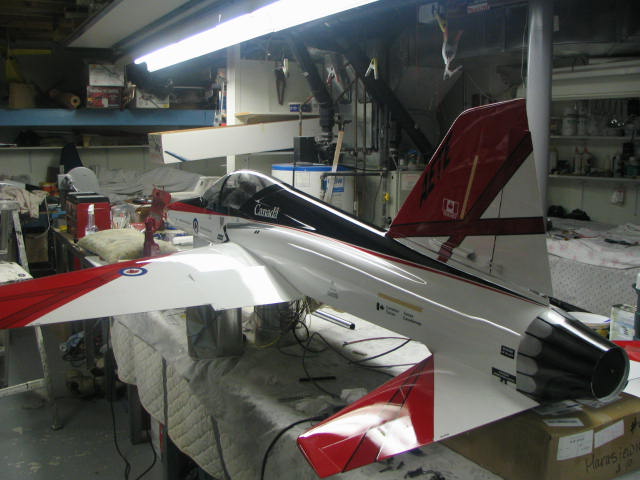

HI all, I'm about ready to test fly my Lightning, any tips about the Lightnings habits would be appreciated.

Looks great except for the guy in the cockpit

Pilot looks fine to me!

Awesome paint job.... They fly awesome!!! A good friend of mine has one that he gives me a pull on now and again... Fly it to the ground with power.... Remember she is a big and heavy bird...

Great work as usual Pete,Pilot looks great,Bulluomini is jealous of your cockpit

Hey Pete, looks awesome, let me know when you are going to do the maiden and I'll try and make it out.

Love the AETE scheme. Make sure you post video of it!!!!!!!

Where did you find your cockpit pilot and dashboard? Is the pilot bluebox? Is your dash home built?
Very beautiful paint job
Glad to be part of the community, just getting into jets myself, flew a Kangaroo with Jetcat 120 (awesome power) this summer and looking forward to fly my Lightning next year with the Behotec180 after I build it this winter

HI Frank Tiano sells the pilots and got the cockpit from RCU, jets for sale, Frank might have the cockpits also.
