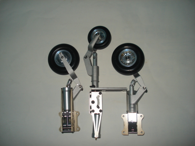

Hi Guys,
I am looking at purchasing a new SM Hawk for a P120SE and wonder if you can assist with some photos and feedback.
1. What is the new undercarriage like, it looks much more scale and better constructed than the previous versions (some photos please)
2. I am assuming the models you are building are the new ARF plus versions, how is the scale outline, it looks much improved?
3. I have heard some stories about severe pitch down on application of flaps for landing, is this just people putting the flaps down at too high a speed or something that needs careful trimming and setup?
4. Would like to see your progress in setup and flying, pls post some details !
regds,
Dale
Australia.
here some pictures for out line with L/G for new ARF PLUS Hawk,
Best regards
Anton
