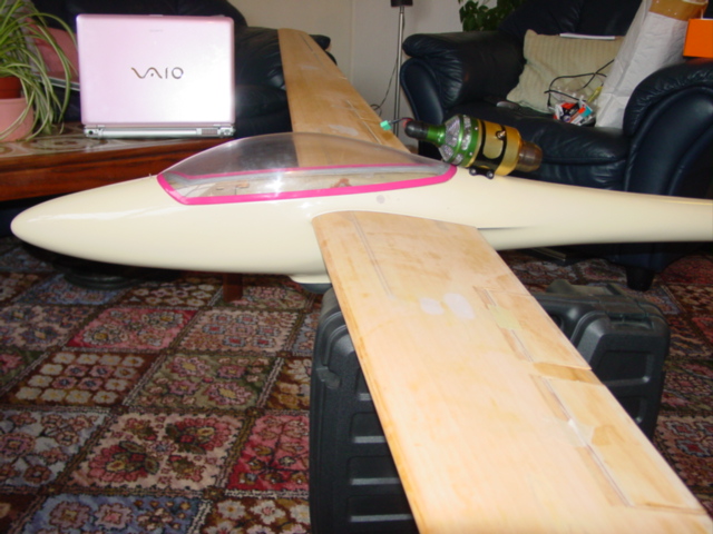

You are looking at something pretty big Peter, I would say 1/3rd scale, probably +5 metres span, there are lots of nice artf's around now, particularly of Eastern European origin. Might be an idea to post in the sailplane forums here.
Just finishing off a near 1/4 scale Salto v-tail sailplane myself for turbine power, it's 142 inch span and built from an old Pat Teakle kit, finished weight will still give around 1:1 T/W with a 5Kg thrust donkey.
Rob.
