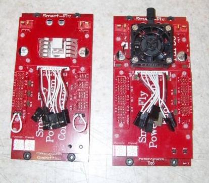

The reason I ask is Smart Fly is starting production on a new powersystem. It is called the EQ-6 powersystem. It is an 8 channel unit that as servo equalization on 6 channels. It also has the adjustable voltage regulator built in. With this unit I could run my Flash on 6 channels. (brakes and retracts are one valve) This system will be available with either the Turbo Reg or Super Reg. It also has an optical ignition kill built in for electronic ignition gas engines. Like the EQ 10 it also has the failsafe switch built in. It should be available by Xmas.

I went to the shop and snapped a photo of both units. The Turbo reg unit is the final prototype, the super reg version in the picture is the first proto, it is missing the ignition kill transmiter on the front of the unit (the black knob). The final version of the Super reg EQ 6 is already installed in a plane.

Great news. My only complaint on Smartfly was 2 seperate units. Couple questions. Can you get it without kill switch and is the EQ-10 going to be combined with Super Reg.

Smart Fly will be selling the unit without the Ign kill receiver that connects to the Ignition module. I don't think the eq 10 will be integrated into an all in one unit, I think that the next "Super Unit" will be more even more channels. I know that Robert is working on some very cool features for the big unit. I don't have any idea when I will have a prototype unit to start flight testing.
