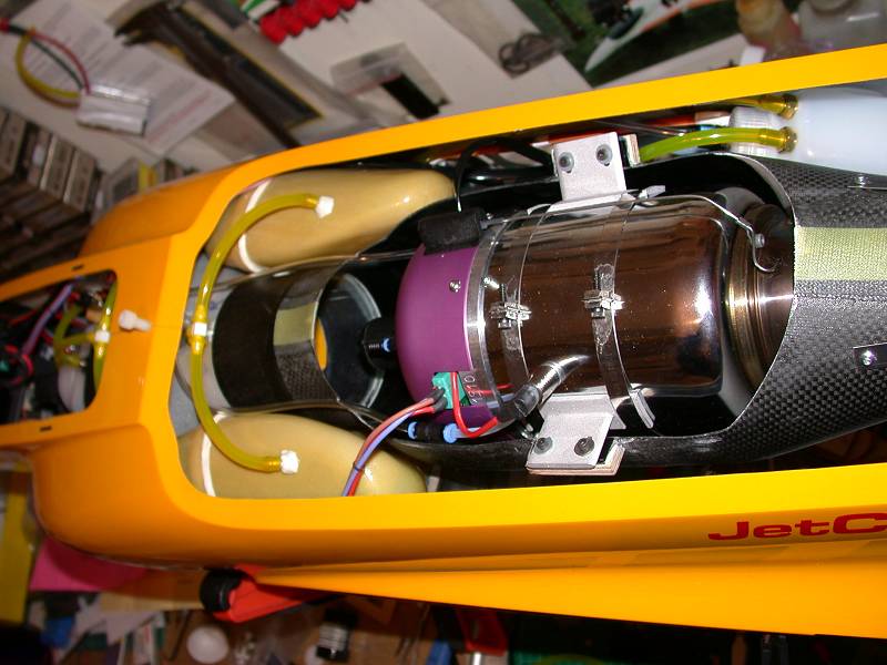

ORIGINAL: digitech
something like this
ORIGINAL: extra 300
Does anybody have a picture of the V3 Kero plug?
Thanks.

ORIGINAL: jseppanen
Now this is the way to go!!! Sandor, when do you think you can start delivery of those?? My P200 is waiting for one, remember!?
ORIGINAL: digitech
something like this
ORIGINAL: extra 300
Thanks.
Thanks.
, email me please.
