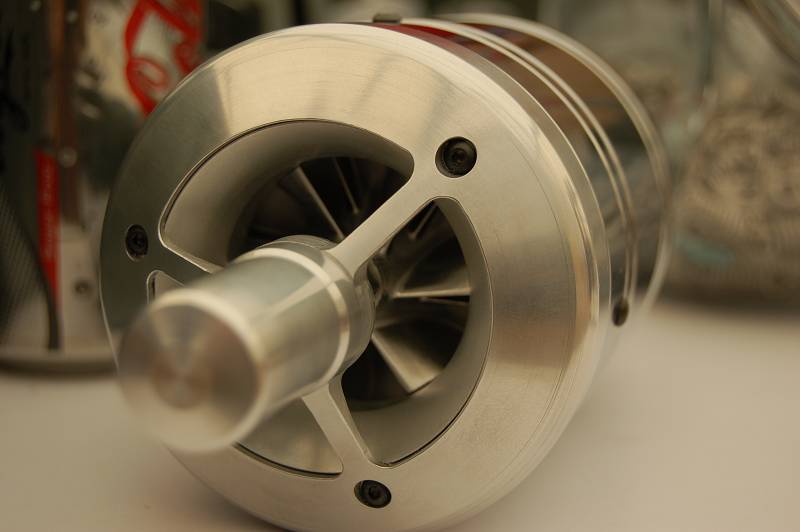

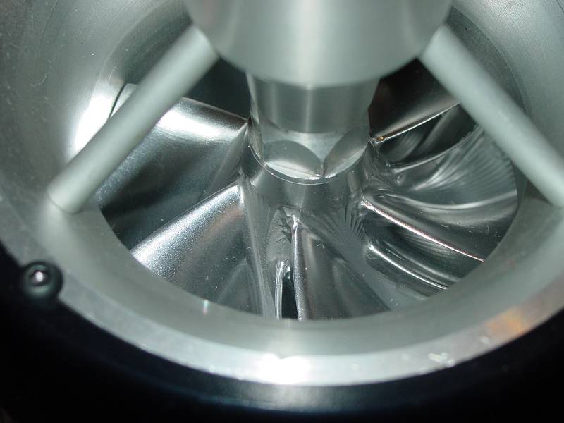

Old 11-25-2007 | 03:40 AM
Robrow's Avatar
Posts: 1,718
From: Southport, UNITED KINGDOM
Default RE: combustion chamber
OK, hopefully just to clarify.......Both Jets Munt and Jet Central are using their own cnc wheels, these are not reprofiled existing wheels but 5 axis machined from solid using aerospace grade alloy to their own cfd designs then clear hard anodised.
The Merlin 170, Rhino 170 and 10kg Merlin 90 all have these type wheels.
As an asside they also cast their own hot end inconel parts.
Hope that helps.
Rob.

Old 11-25-2007 | 04:50 AM
rcguy!'s Avatar
My Feedback: (69)
Posts: 2,859
From: Chesterland , OH
ORIGINAL: Robrow
Hope that helps.
Rob.
Who is "they"?
Dave
Old 11-25-2007 | 05:00 AM
Robrow's Avatar
Posts: 1,718
'They' is Jets Munt and Jet Central.
Rob.
