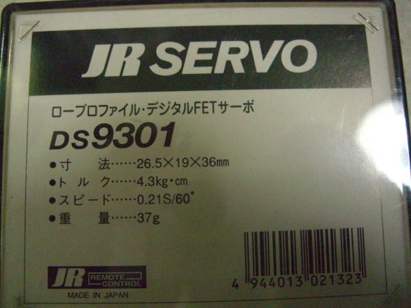

To easily convert metric torque to standard....go to http://nmbtc.com/Calculators/converter.swf
Click Torque tab and click on Kg/cm in choose units row, enter Kg in "convert from" window. Click "calculate". Read oz/in.
Very accurate. I get 55.5 oz. required....not a lot of torque but according to the manufacturer, the 75 oz. of your 3421 should be adequate. I think they're using small servos to minimize tail weight. You decide whether overkill on the stab servos warrants lead in the nose,
W.
FWIW Alan, the JR DS9301 is the Japanese version of the western JR DS3421. They are identical servos.

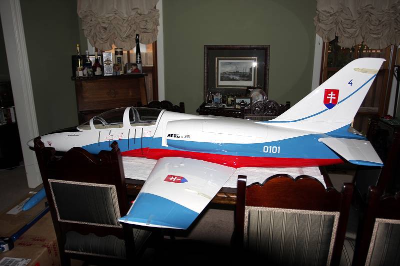

Old 12-25-2007 | 07:37 AM
Joined: Jun 2003
Posts: 234
From: Melbourne, AUSTRALIA
Default RE: Skymaster L39 Elevator servo
Thanks for that info. I think I will go with the 9411.. Here is a pic of my new airframe.. It's big in person!

ORIGINAL: Pyolet
W.
Thanks Woody!
I was coming up with a different number, I was doing KG/IN vice KG/CM on another converter...makes a huge difference. I happen to have one 3421 and one 9411. The 3421 fits MUCH better than the 9411 but the 9411 still fits fine and has so much more torque. Still undecided....

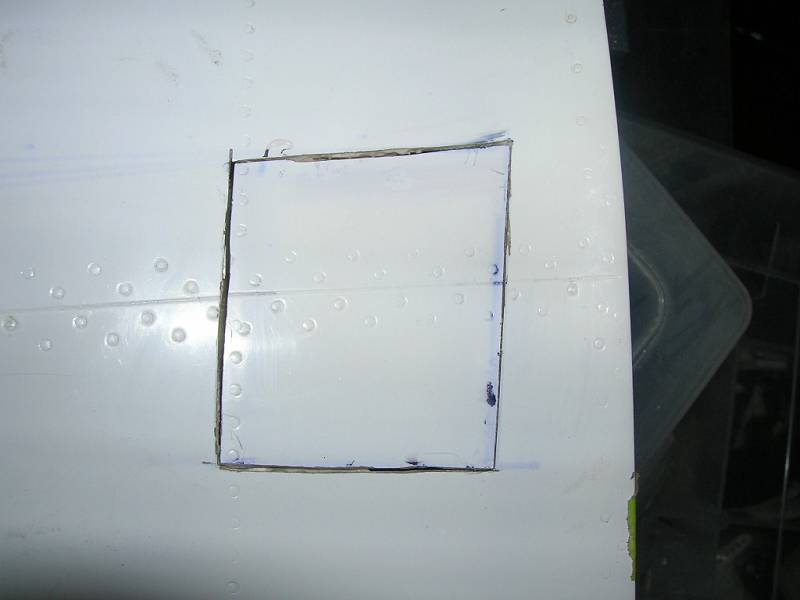

Old 12-29-2007 | 08:04 PM
Joined: May 2007
Posts: 106
From: , SC
Well, I went with the 9411 and installed the first one tonight. I did not like dropping the servo in through the end. Makes it difficult to align perpendicular to the elevator hinge line particularly because of the taper of the stab. Also its hard once you get it aligned to be sure it is glued in properly. So...I cut an access hatch. Its not square due to the channel the stab sits in is tapered along with the stab. Side to the right (inboard) is cut perpendicular to the hinge line so the servo arm will parallel that line and the outboard line is cut just outside of the rivet line. Glued the blocks in place, hatch fits great. Dark stuff around the edge is ink from the marker I used to mark the cutout lines...tried to clean them off but I couldnt get all the ink off. Oh well, the plane has a date with the paint booth.
Mike

Old 12-30-2007 | 09:23 AM
My Feedback: (61)
Posts: 844
From: Middlesex, NJ
Hi Mike,
Just a personal thought and advice.
I think you have weakened the stab quite a bit by cutting out the access hatch. The method used by others of installing the servos from the root access does work nicely.
Anyway, I would strongly suggest you building a balsa or ply box around the cutout to reinforce the opening.
Just my 0.02C
Thanks - Adil
Old 12-30-2007 | 10:16 AM
Joined: May 2007
Posts: 106
From: , SC
Adil,
Thanks for your suggestions. Two of the sides are already lined with balsa. Behind that balsa...it is LOADED with what looks like aeropoxy to hold in tubes for the stab spars. Ill take your advice and complete the other two sides.
Mike
